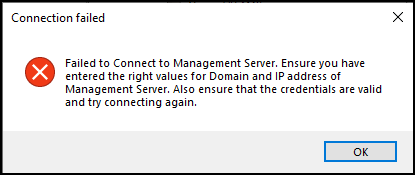

After upgrading the Video Push integration software to the latest version (3.2.3) error messages can appear if the system is using certificate based encryption for authentication with the XProtect Management Server.
Systems which are already using certificates should skip steps three and four in the list below.

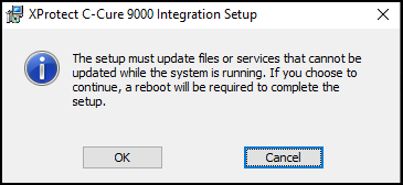

It is recommended to restart the CrossFire Framework Service & CrossFire Server Component Framework Service after the integration software components have been upgraded. The installation wizard should show the following dialog if a full system reboot is required.
