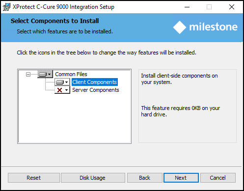

  2. Click XProtectVideoPush-v3_XX-CCure9k-vX-XX.msi to start installation.
  3. Click Next to enter the component selection step. If you are installing the components on a client machine only, open the Client Components list and select the Will be installed on local hard drive option. The Server Components list should display a red X icon.
