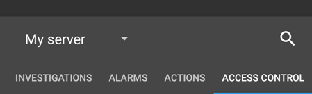

- Open Access control:
- Android - Tap the Access Control tab, then tap
and select Access requests.
