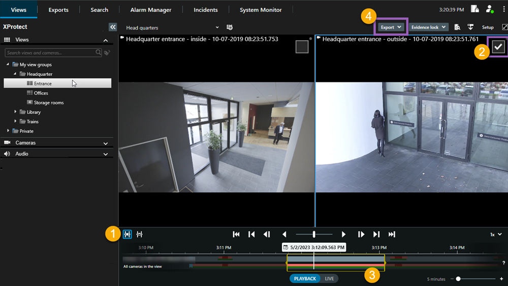

If you’ve already found the recorded video you want to export while in playback mode, you can add it to the Export list this way:
Add video sequences to the Export list when in playback mode in XProtect Smart Client.
Steps Action
Show the time selection brackets on the timeline tracks.
Select the cameras that you want to include in the export.
Drag to change the start and end time for the export.
Select Export > Add to export list.
