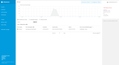

  1. Select Errors in the main menu, then select Manage error filters.
    The Manage error flter on the Errors page in Milestone Customer Dashboard.

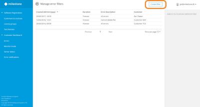

    The created error filters for your customers will be displayed on the Manage error filters screen.
  2. Select Create filter.
    The Create filter button on  the Manage error filter page in Milestone Customer Dashboard.

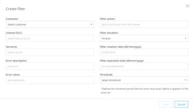

  3. In the Create filter window, fill out all applicable properties for the selected filter. Start from the upper-left field (Customer) and narrow down your filter criteria by selecting details from more fields. See Error filters (properties).
    As a minimum, you must specify Customer, License and Server name to save a filter.
    The Create filter window.
