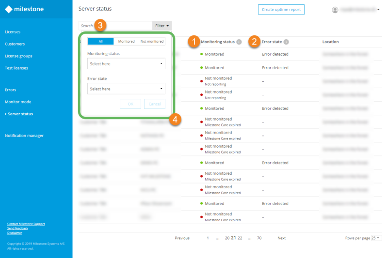

Servers that meet all these criteria will have a Monitoring status
of Monitored, and will report an Error state
to Milestone Customer Dashboard.
Search
for custom results using the data from any of the columns.
Filter
results by a specific Monitoring status or Error state.
