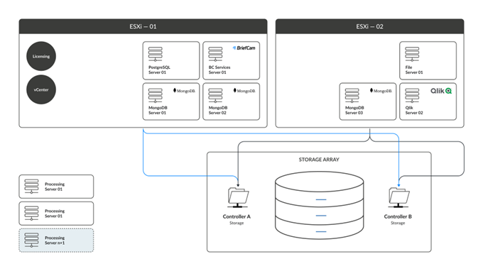

BriefCam solutions involve a common UNC share for storing artifacts, such as images and video clips. This share is provided by one of the virtual machines running on a hypervisor. To provide high availability for this virtual machine as well for all the others, all the virtual machines' disks need to be stored on a redundant storage array connected to two (or more) hypervisor physical machines.
Diagram #1:
Note that:
  • ESXi is a hypervisor, which is software that creates and runs virtual machines, providing CPU/RAM.
  • Storage array hosts all the virtual machines’ data and provides HA connectivity to both hypervisors allowing running a specific virtual machine on a single hypervisor and in case it fails to ”move” the virtual machine to the other hypervisor.
  • vCenter Server is VMware’s centralized management utility. It is used for managing virtual machines. 

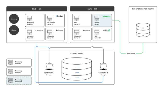

Diagram #2 – with Veeam:
The addition of Veeam (a backup and recovery solution) allows for a higher degree of backup that does not rely on ESXi.

Veeam
With the addition of Veeam you can achieve a higher degree of backups as you are not only relying on multiple ESXi instances that are connected to shared storage, but you are also backing up the virtual machines themselves, into an ”external” location. Note that setting up Veeam has additional licensing considerations and is not considered as part of the standard setup described in this document.
