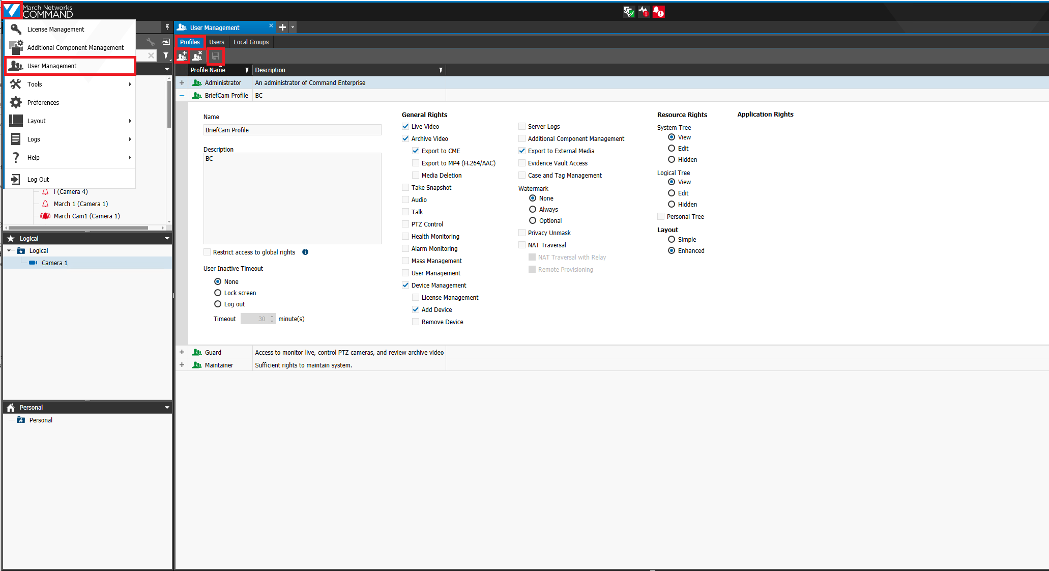

Creating a BriefCam User Profile
In the March Networks CES administration:
  1. Click the March Networks logo in the top left corner.
  2. From the drop-down list, select the User Management option.
  3. Select the Profiles tab.
  4. Click the Add New Profile button (top left part of the screen).
  5. Create the BriefCam Profile.
  6. Enable the following rights (leaving all other settings as-is):
    • Live Video
    • Archive Video
    • Export to CME
    • Device Management
    • Add Device
    • Export to External Media
Click the Save icon (top left part of the screen).

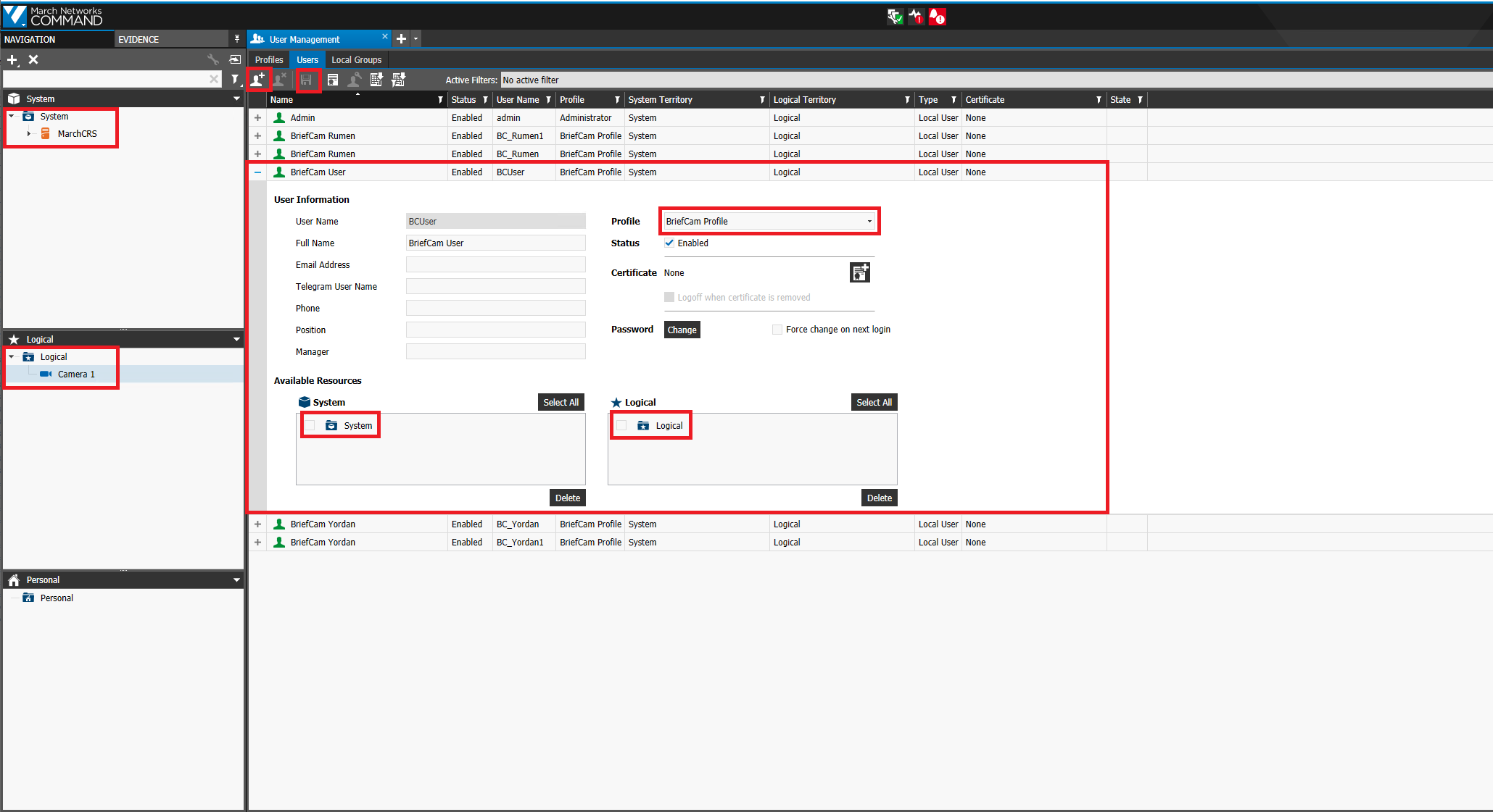

Creating the BriefCam User
  3. Select the Users tab.
  4. Click the Create New User button.
  5. Fill in the User Name.
  6. From the Profile drown-down list, select the previously created BriefCam Profile.
  7. Set the Status to Enabled.
  8. Set the User Password.
  9. Drag and drop the System and Logical resources that will be used by the BriefCam integration.
  10. The System and Logical resources can be Recorders, Individual Cameras or the Whole System. If the integration needs to access the entire CES system, just drag and drop the entire System and Logical folders. Make sure only to drag and drop the resources that will be used.
  11. Click the Save icon.

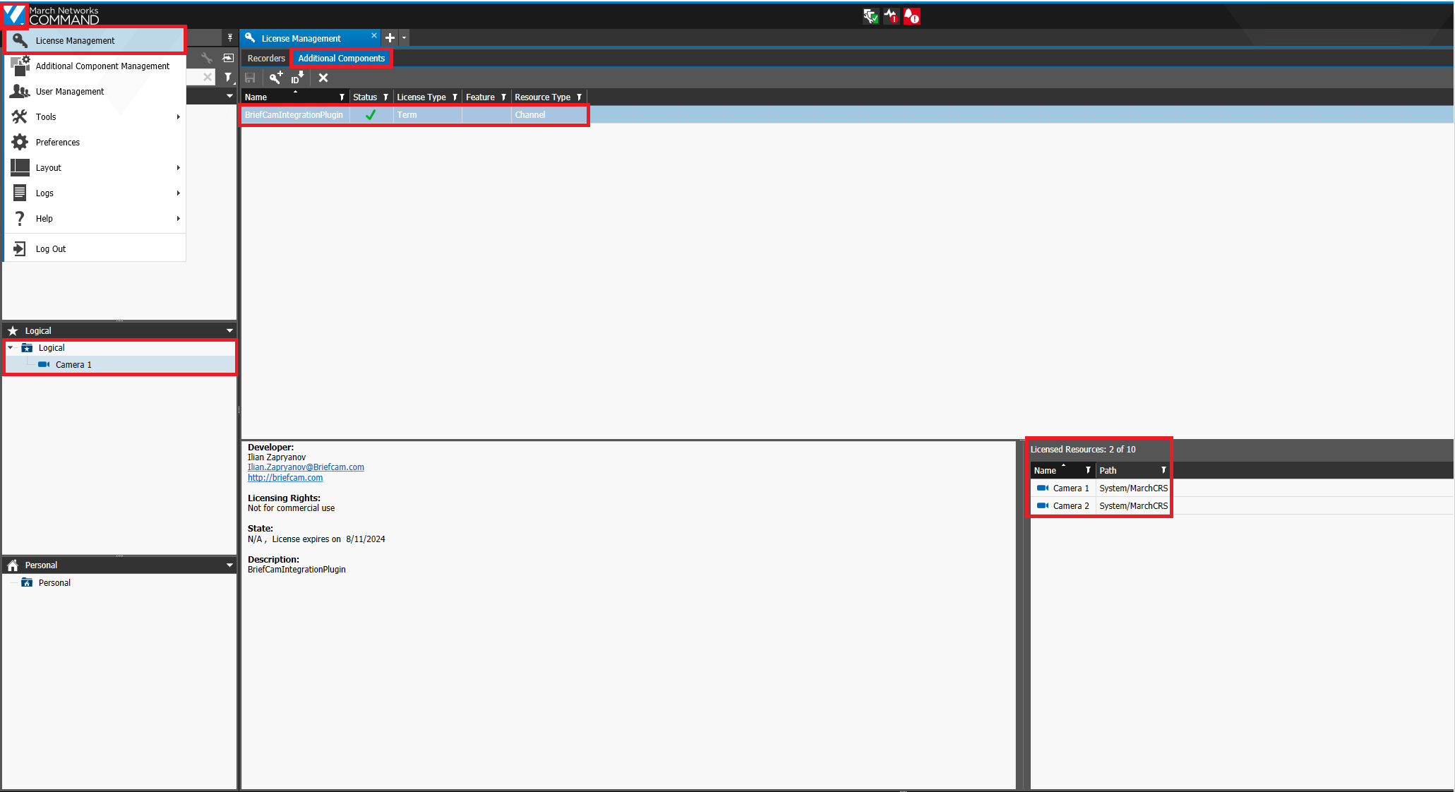

Adding the System/Logical Resources to the BriefCam Integration Licensing
  2. From the drop-down list, select the License Management option.
  3. Select the Additional Components tab.
  4. Select the BriefCamIntegrationPlugin.
  5. Drag and drop all needed cameras from the Logical tree to the Licensed Resources.

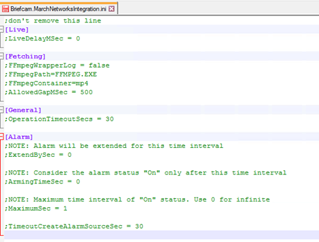

Configuring the Integration
When the March Networks plugin is installed, you’ll have a Briefcam.MarchNetworksIntegration.ini configuration file, which by default is located at: C:\Program Files\BriefCam\BriefCam Server\plugins.
This file includes the following parameters:
  • LiveDelayMSec – Sets a delay for incoming live streams if the clocks of the VMS and BriefCam are out of sync and the live stream times are different than the BriefCam time.
  • FFmpegWrapperLog – Enables additional logs for FFmpegWrapper.
  • FFmpegPath – The path to the ffmpeg.exe file.
  • FFmpegContainer – The type of container used by FFMPEG.
  • AllowedGapMSec – The number of milliseconds gap allowed in the fetched video.
  • OperationTimeoutSecs – The timeout for all general operations between the VMS and BriefCam.
  • ExtendBySec – The alarm will be extended for this time interval.
  • ArmingTimeSec – The alarm status will be considered "On" only after this time interval.
  • MaximumSec – The maximum time interval of "On" status. Use 0 for infinite.
  • TimeoutCreateAlarmSourceSec – Timeout for creating alarms.
