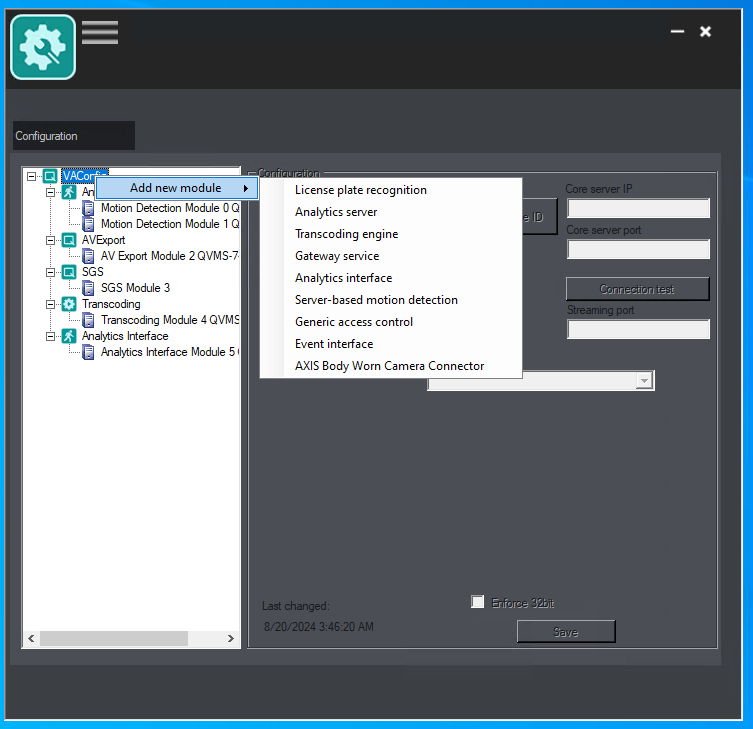

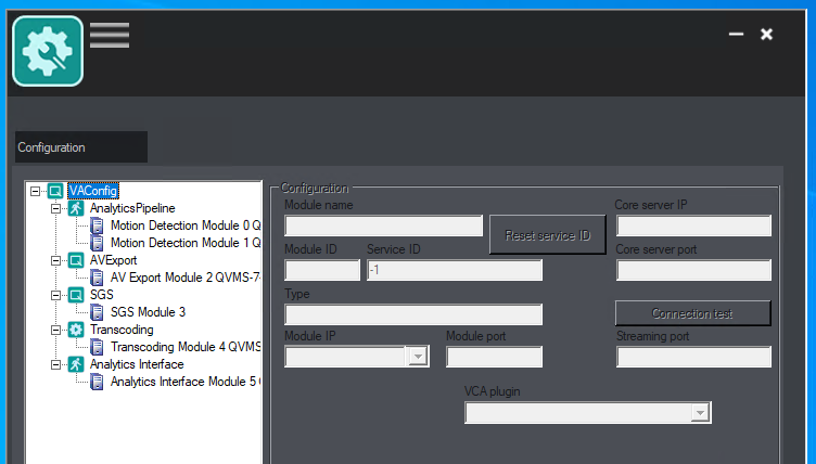

  3. Open the VMS VA Administration Tool.
  4. Right-click on the VAConfig root node.
  5. Select Add new module and then Analytics interface.

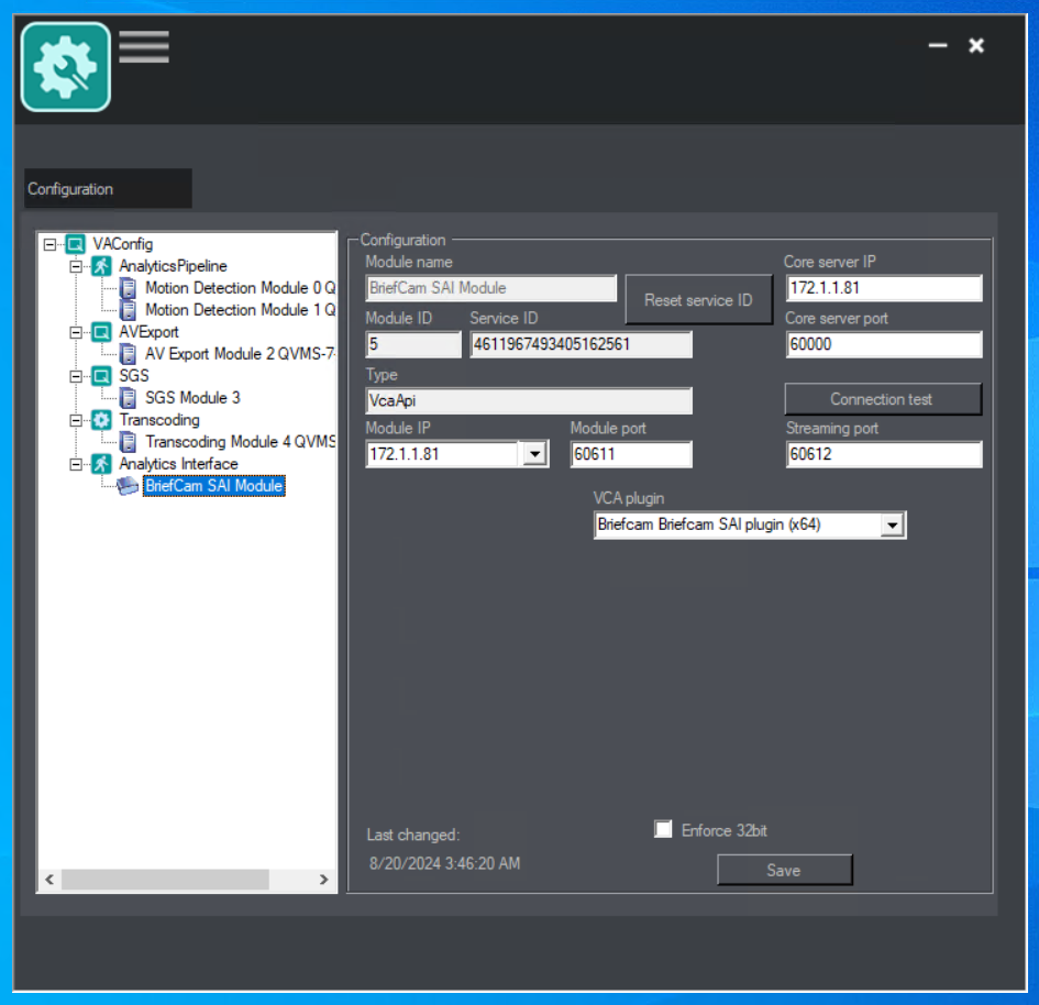

  6. The configuration fields will be populated for you. Check that in the VCA plugin field, the BriefCam plugin is selected.
  7. Click the Save button.

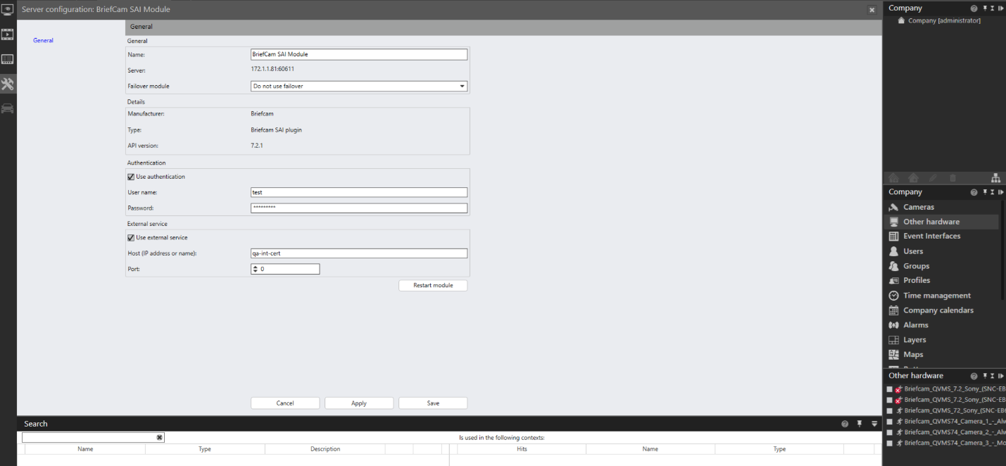

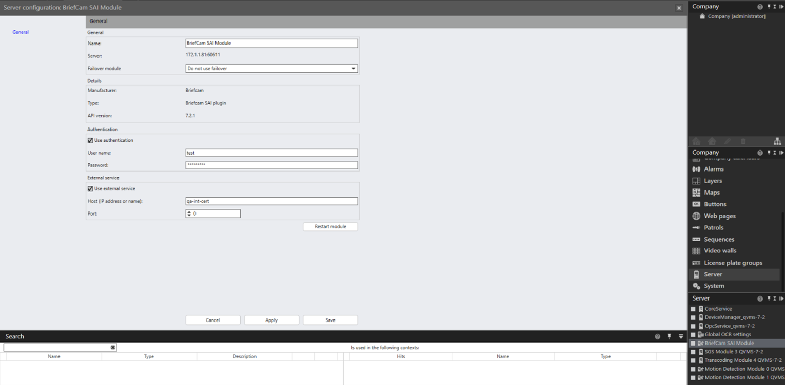

  8. Open the QVMS Client with Administrator.
  9. On the left-hand side, navigate to the Configuration Mode.
  10. On the right-hand side, open the Server menu.
  11. Select the BriefCam SAI module.
  12. Set the Username and Password for BriefCam.
    Note that the user must be a Basic User (and not an administrator user) and have access to the rules that need to be sent to QVMS.
  13. Set the Hostname of the BriefCam instance. (Remember that IP addresses will not work.)
    Note that the value in the Port field is not used and should be left as 0.
  14. Click the Save button.

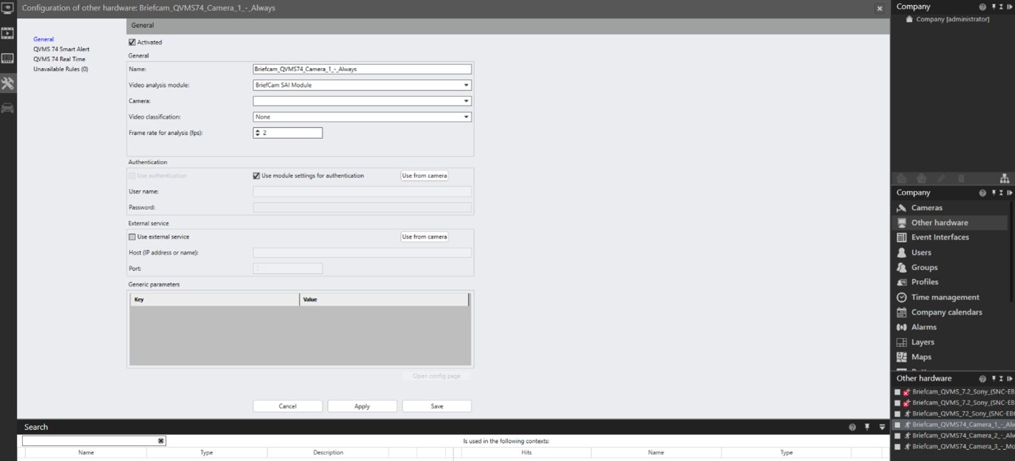

  15. Navigate to the Other Hardware menu.
    Note that under Other Hardware, all cameras from BriefCam directories will be added as channels.
  16. Select a Camera channel.
  17. From the Camera Channel menu, additional mapping can be done for the events that are received by BriefCam.

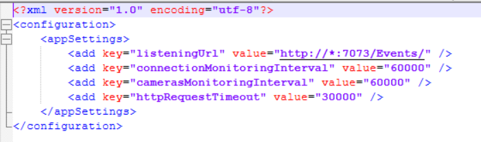

When the SAI plugin is installed, you’ll have a Briefcam.QognifySai.dll.config file, which by default is located in the SAI installation directory.
This file has the following parameters:
  • listeningUrl – The URL that listens for incoming BriefCam events, which by default is set to listen to all addresses.
  • connectionMonitoringInterval – The interval in ms between polling KeepAlive requests. The default is 60000 ms.
  • camerasMonitoringInterval – The interval in ms between fetching cameras list. The default is 60000 ms.
  • httpRequestTimeout – The timeout for the HTTP client to send a request to BOA (BriefCam Open API). The default is 30000 ms.

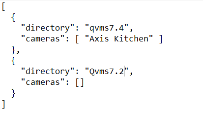

When there is a single directory in BriefCam, you can filter out the needed cameras. This is done with the VMSCameraList.json file. The file is located at: <QognifyVMSInstallationDirectory>\VersatileApplications64\VcaPlugin\. The VMSCameraList.json file contains the mapping between BriefCam directories and their cameras and other hardware channels that are created in the Qognify VMS. Cameras can be filtered by directory or by directory and camera name.
To add a directory to the file, use the following syntax:
"directory": "<Directory Name>",
"cameras":[]
· To add a directory with specific cameras to the file, use the following syntax:
"cameras":[“<CameraName1>”, “<CameraName2>”,]
When there are more directories in BriefCam than are needed in QVMS, you have to filter out all the cameras from the needed directory. Cameras have to be filtered by directory and camera name. Multiple directories can be included as a list in the VMSCameraList.json file.
To add a directory with all cameras from it to the file, use the following syntax:
"cameras":[“<CameraName1>”, “<CameraName2>”,<…….>,]
To add multiple directories with all cameras from them to the file, use the following syntax:
"directory": "<Directory Name2>",
"cameras":[“<CameraName3>”, “<CameraName4>”,]
There is an example file in the Plugin installation directory called VmsCameraListSample.json. The following is an example configuration:
