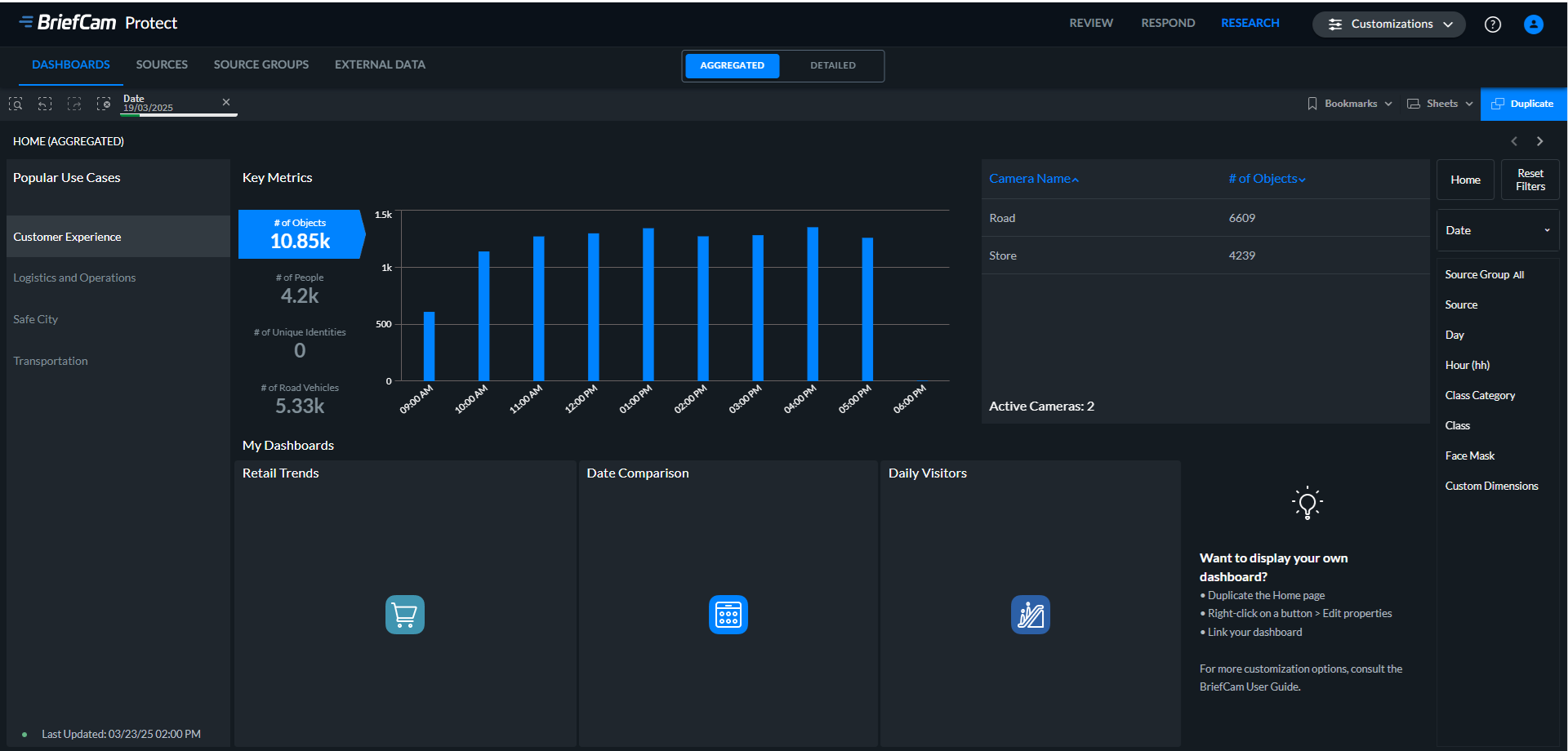

RESEARCH Home Screen
When you click the RESEARCH tab, you’ll see the RESEARCH Home screen, which allows you to switch between different versions of the home page tailored for specific use cases, including Customer Experience, Operations, Safe City, and Transportation. On this screen you will also find common key metrics, the active cameras, and the links to dashboards relevant to each use case.

You will see two options at the top center of the screen where you can toggle between the AGGREGATED and DETAILED dashboards.
