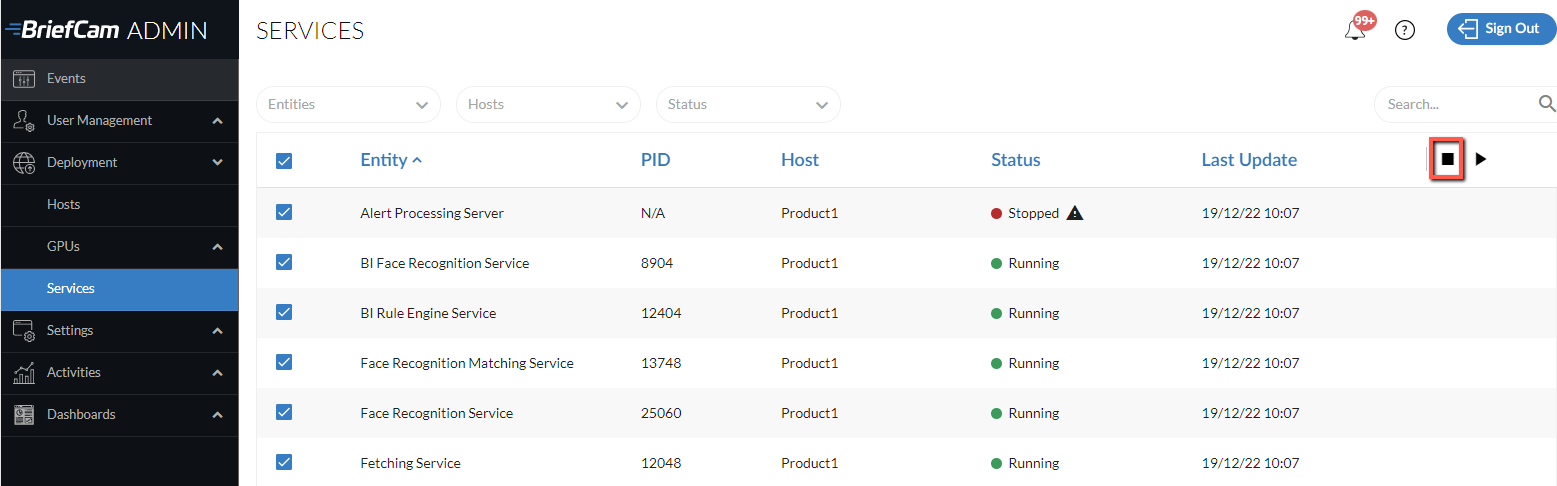

  3. Launch the BriefCam Administrator Console and stop the BriefCam services.

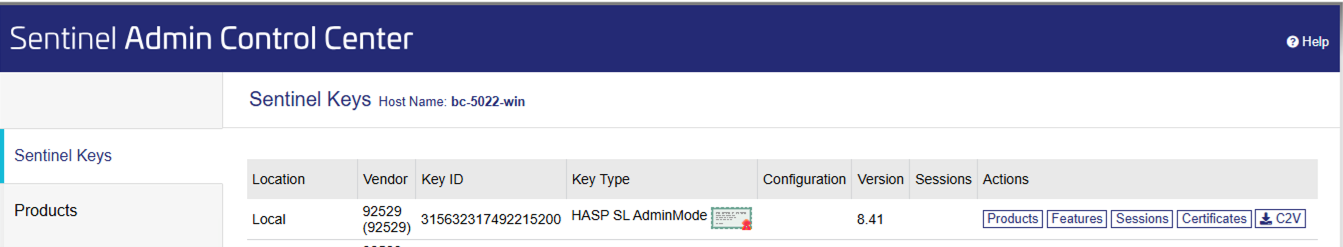

    1. Open the Chrome/Edge browser and go to http://localhost:1947.
    2. Click on the Sentinel Keys option.
    3. From the Actions column, click C2V.
    4. Log into the BriefCam Portal at https://www.briefcam.com/support/ and open a ticket. You’ll attach the C2V file and request a V2C file with the new features.
    5. The BriefCam Customer Success team will email you the requested V2C (vendor to client) file.

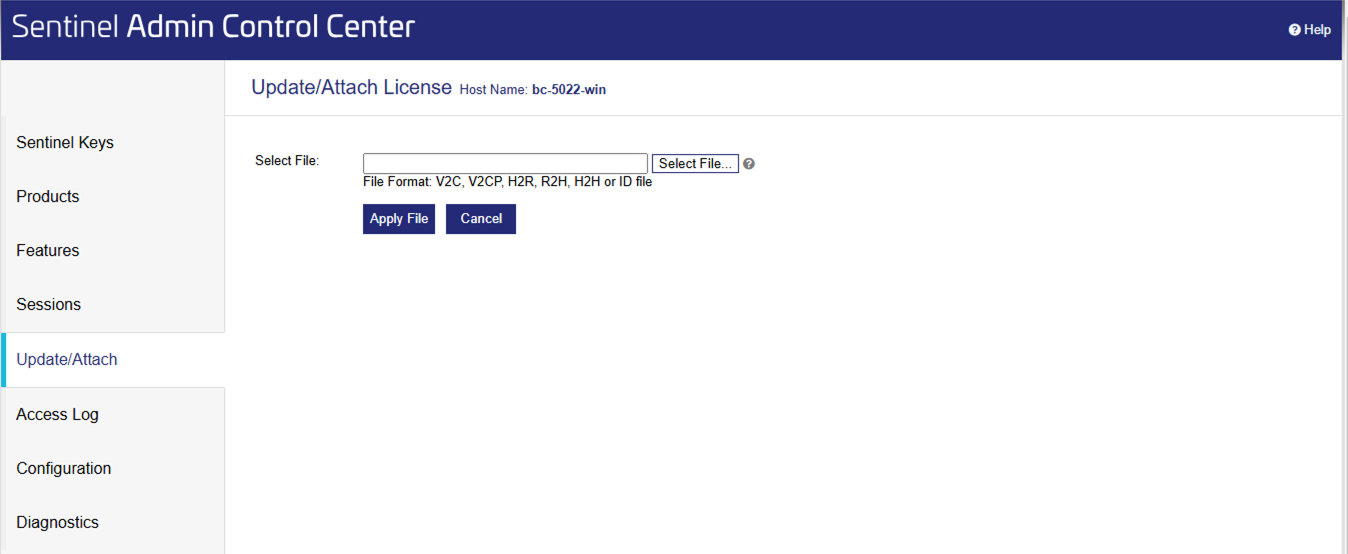

    6. Open the Chrome/Edge browser and go to to http://localhost:1947.
    7. Click the Update/Attach option.
    8. Click the Select File button and select the V2C file that you received from BriefCam.
    9. Click the Apply File button.

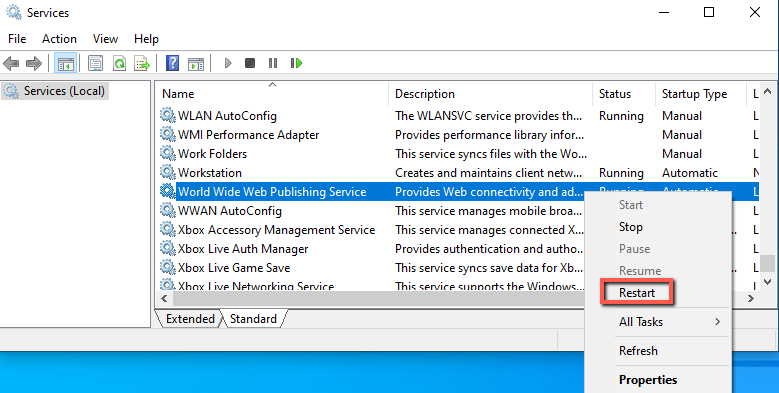

  20. Restart the IIS services on the machine where the BriefCam Web Services are installed (by opening the Windows Services, right-clicking on the World Wide Web Publishing Service and clicking Restart).
    Note
    After restarting the IIS services, it might take a minute or two to get results when filtering objects for the first time after the restart.
