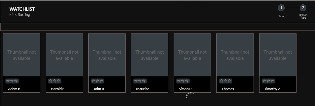

When I'm uploading images to a face watchlist, why am I getting the Thumbnail not available message?

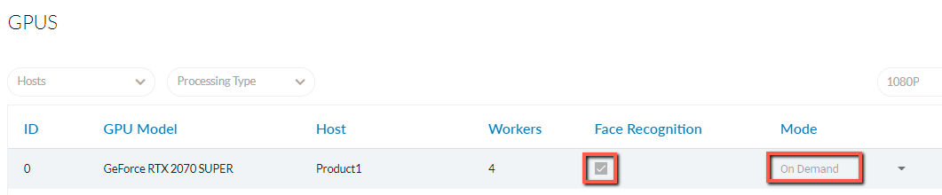

The GPU must be set to On Demand mode with the Face Recognition column checked. If you are changing the mode to On Demand, remember to also start the Processing Server service.
