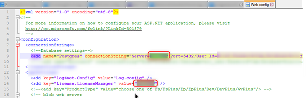

  3. In both Web config files (C:\Program Files\BriefCam\WebServices\ProWebApi\webConfig and C:\Program Files\BriefCam\WebServices\AdminApi\web.config), check that the server name is defined correctly (in the connectionString="Server= row) and in the BriefCam Administrator Console's clientNotificationEndPoint environment setting.
