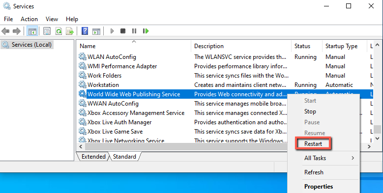

  6. From the Windows services, restart IIS (by right-clicking on the World Wide Web Publishing service and clicking Restart).
