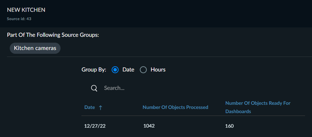

When working with RESEARCH source groups, the “Number of objects ready for dashboards” may remain low even when the “Number of objects processed” keeps increasing.
