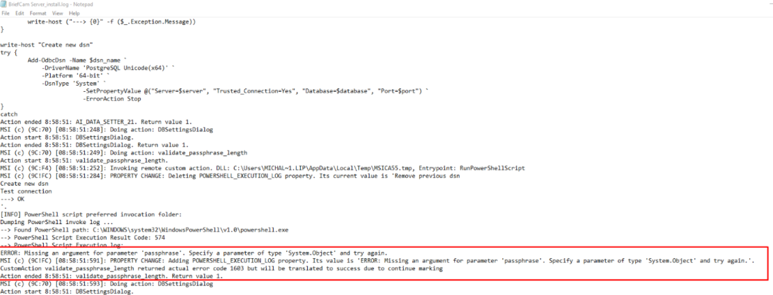

Installing the server fails and in the BriefCam Server_installer.log I’m getting an error about the passphrase. What can I do?
Version2024r2
LanguageEnglish
If you see the following error, it means that you used a password that does not meet your organization’s password policy.
ERROR: Missing an argument for parameter 'passphrase'. Specify a parameter of type 'System.Object' and try again.
