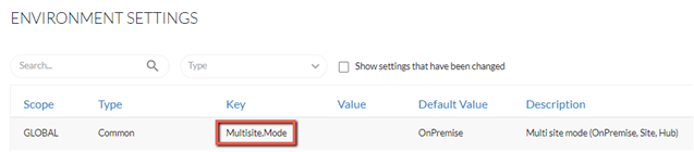

Log into the BriefCam Administrator Console.
From the Settings section, open the Environment Settings screen.
You’ll now configure the system to work as a Hub.
Set the Multisite.Mode environment setting to Hub.
