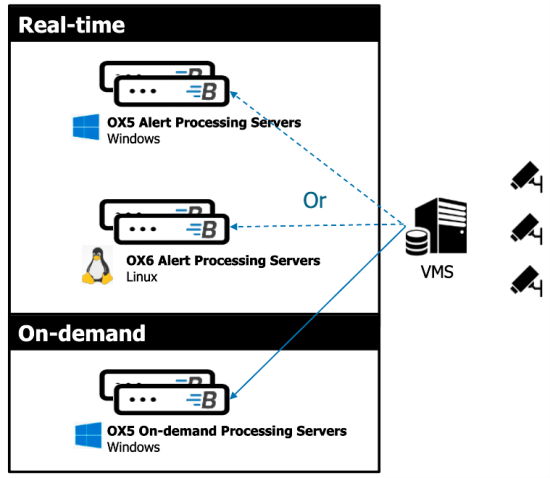

The Next-Gen engine is available for distributed deployments that include all the following:
For example, if you have a separate Linux server where you will have BriefCam’s Alert Processing Server running and you integrate with Genetec, the Next-Gen engine is the recommended choice.
If you do not have one of the three items above, you’ll continue to use the OX5 engine. For example, if you are using a non-supported VMS or only use the REVIEW module, you will use the OX5 engine.
The OX5 real-time engine cannot be used together with the OX6 real-time engine.

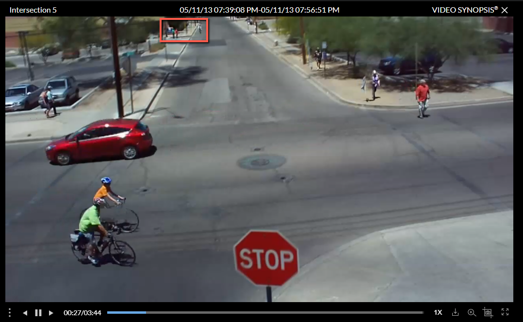

  • The Next-Gen engine does not handle very small objects. Small objects that are not being detected can be seen in the image below (in the red bounding boxes).
