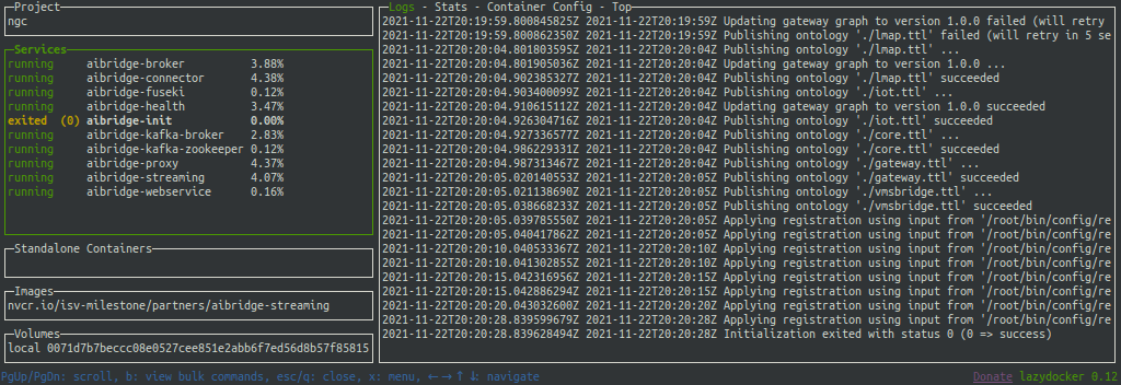

You can also run lazydocker from the folder containing the docker-compose.yml file to open a user interface that will help you to monitor the status of the deployment. Lazydocker is an open-source terminal interface for managing Docker environments and enables you to inspect Docker objects without using terminal commands.
In the Lazydocker user interface, you can see the log output of each container, among other things.
The image below is an example of a successfully completed init container's log output.
