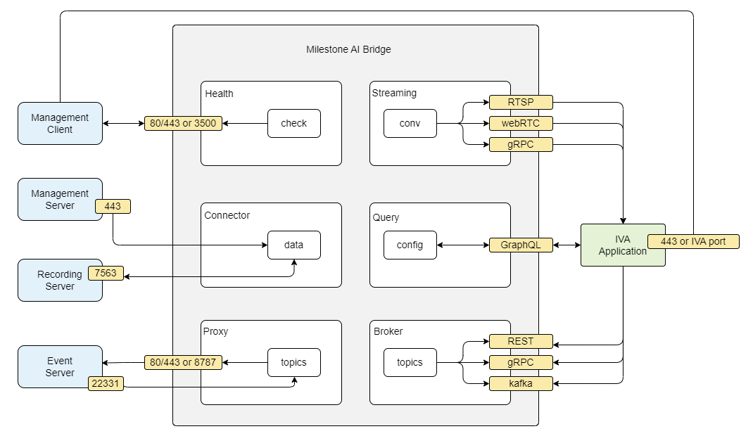

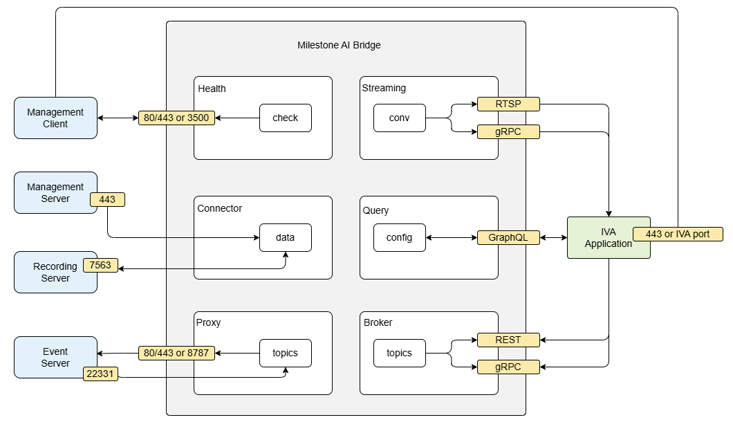

Ports used by the integration
Illustration showing the different ports and protocols in a Milestone AI Bridge integration.

Ports used by Milestone AI Bridge
The port numbers vary depending on whether the processing servers use Kubernetes or Docker Compose.
Docker Compose
Port number Protocol Owner Purpose
3500 REST Milestone AI Bridge Health container Health check of processing servers.
8787 VPS Milestone AI Bridge Proxy container Video and metadata.
Kubernetes
80 SOAP and API Rest nginx-gateway-controller
Health check of processing servers. Video and metadata.
The purpose of port 80 and port 443 is the same.
  • Unsecured communication: use port 80.
  • Secured communication: use port 443.
443 SOAP and API Rest
