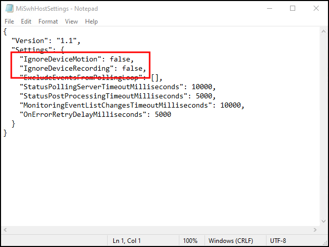

  1. Go to the CCure 9000 server.
  1. Open the following file with Notepad or a similar text editing application C:\ProgramData\VideoOS\MiSwhHost\MiSwhHostSettings.json
  1. Change the default false value to true on the following lines of code and save the file.
"IgnoreDeviceMotion" : false,
"IgnoreDeviceRecording" : false,
  1. This will prevent the XProtect motion detection, and video recording events from displaying in the CCure 9000 alarm list.
