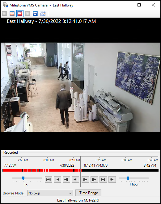

The options for controlling video playback are all included at the bottom of the video playback window.

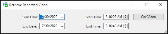

Time Range (Button) |
Specify start time and end time for the video segment. This opens a new window:
After making a time range selection, click the Get Video button, and the video time line immediately begins at the start time and plays the recorded video. |
Video Playback Controls |
These buttons control video playback: Skip to beginning of oldest recorded sequence, Skip to next oldest sequence, Play backwards (changes to Pause when activated), Skip one image backwards | Skip one image forwards, Play forwards (changes to Pause when activated), Skip to next sequence, Skip to beginning of most recent recorded sequence. |
Speed |
Adjust the playback speed using this slider. Available options are 0.1x, 1/4x, 1/2x, 1x, 2x, 4x, 8x, 16x, and 32x. |
Timeline Span |
Adjust the time duration displayed in the time line on the video playback window. |
Browse Mode |
Select how the playback handles gaps in recordings. Select these options from the list: No Skip, Skip Gaps, or Stop at sequence end. |
