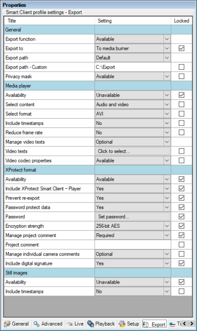

To further control how exported media are handled, the VMS - in extension to security permissions - supports ‘Smart Client Profiles’ which control how the XProtect Smart Client behaves and what features or functions are available for the user – including what export formats and functions are available to the VMS user with export permissions.
To ensure maximum security of the exported media, and to prohibit unauthorized distribution and viewing of the exported media, it is recommended to set the Smart Client Profiles export settings to the following:
  • Export toàTo media burner
  • Media playeràUnavailable
  • Still imagesàUnavailable
  • XProtect formatàAvailable
  • Include XProtect Smart Client – PlayeràYes
  • Prevent re-exportàYes
  • Password protect dataàYes
  • Passwordàset to a predefined password
  • Encryption strength’ à256-bit AES
  • Manage project commentsàRequired
  • Include digital signatureàYes
The ‘Locked’ checkbox must be selected for all of the above settings to ensure that a XProtect Smart Client user cannot override them.

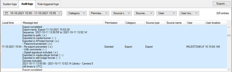

To track user activity in the VMS, and to discourage users from exporting media without proper reason, the VMS will always create an audit log for every export action. The audit log, as can be seen in screenshot below, includes details about exported devices and time periods as well as formats used, usage of password protection (encryption) and digital signatures, and so forth.
The audit log can then be used to audit who did what in the VMS and check if there were legitimate reasons for the actions performed.
In extension to the standard creation of audit logs for all administration of the VMS and media exports, the VMS can also be configured to create audit logs for all viewing of live and recorded media, including activation of events, outputs, control of PTZ, and so forth.

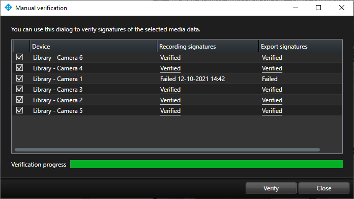

Verifying Digital Signatures
When clicking the ‘Verify Signatures…’ button, a new dialog is opened, and the media database signatures are analyzed one device at a time. Depending on the number of devices included in the export and the length of the exported media, the verification process may take some time to complete – though progress is shown during the verification. Once the verification is completed, XProtect Smart Client will display if the media databases have been tampered with or if the integrity is still intact.
If the validation fails, the dialog box will display the time of the first failed segment of the media database, as shown below.

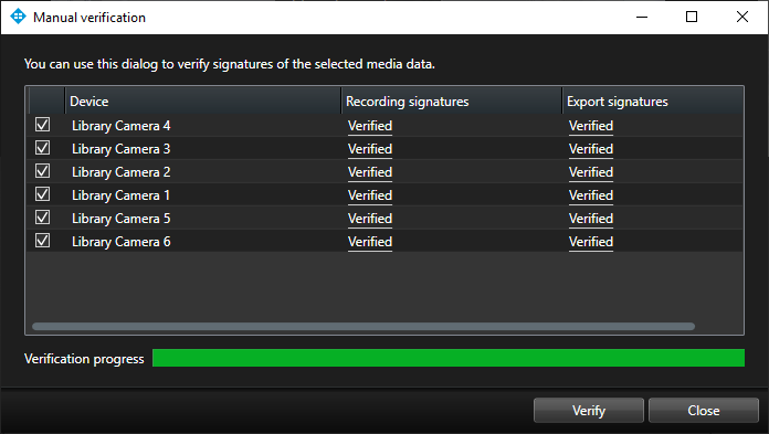

The screenshot below shows an example of correctly validated media databases.
