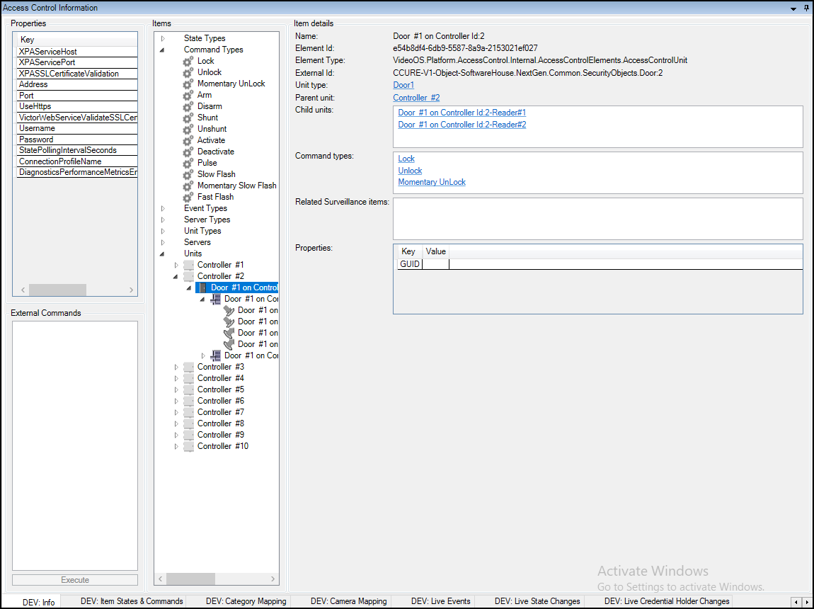

DEV: Info |
This tab has the entire hierarchy of servers, devices, statuses, commands, and events in the system. Selecting an individual object allows for identification of any properties associated to it. |

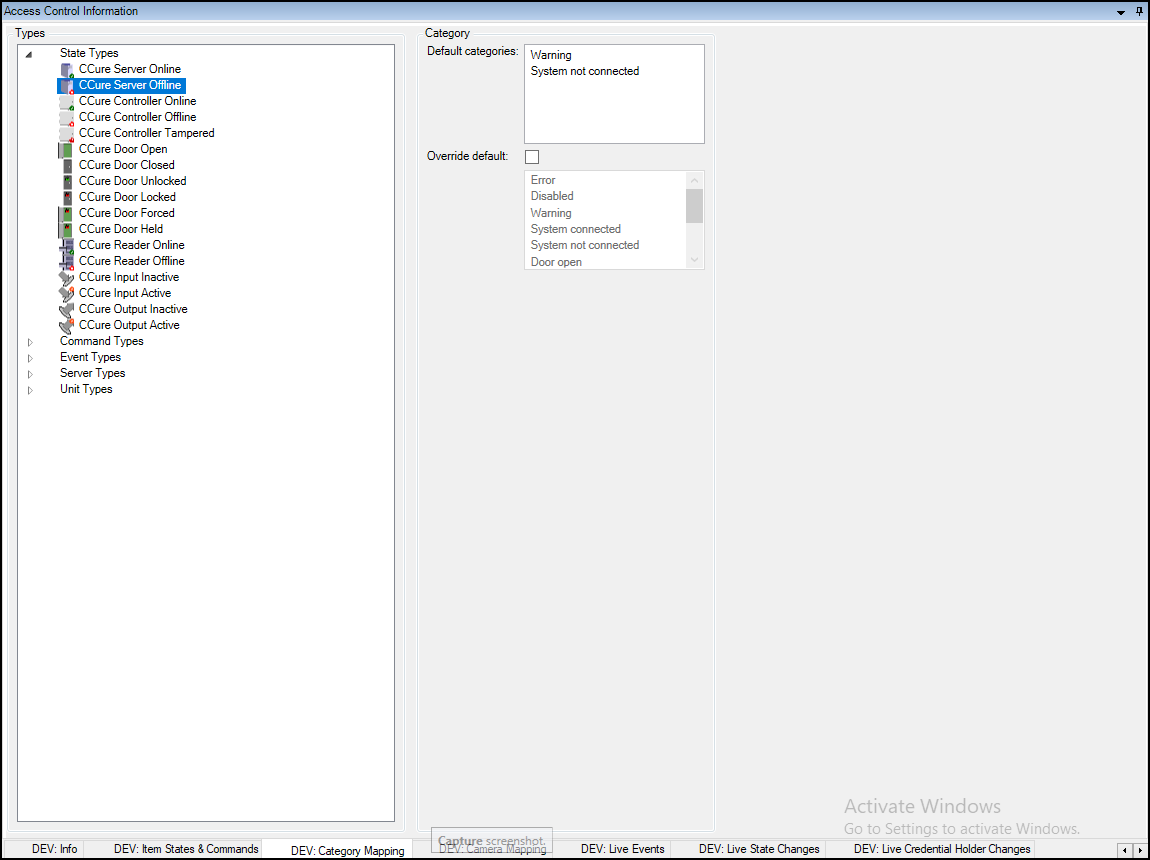

DEV: Category Mapping |
The Category Mapping tab is primarily used for debugging during development making sure that the Events, Commands, States, Servers, and Devices are mapped correctly between CCure and XProtect. |
