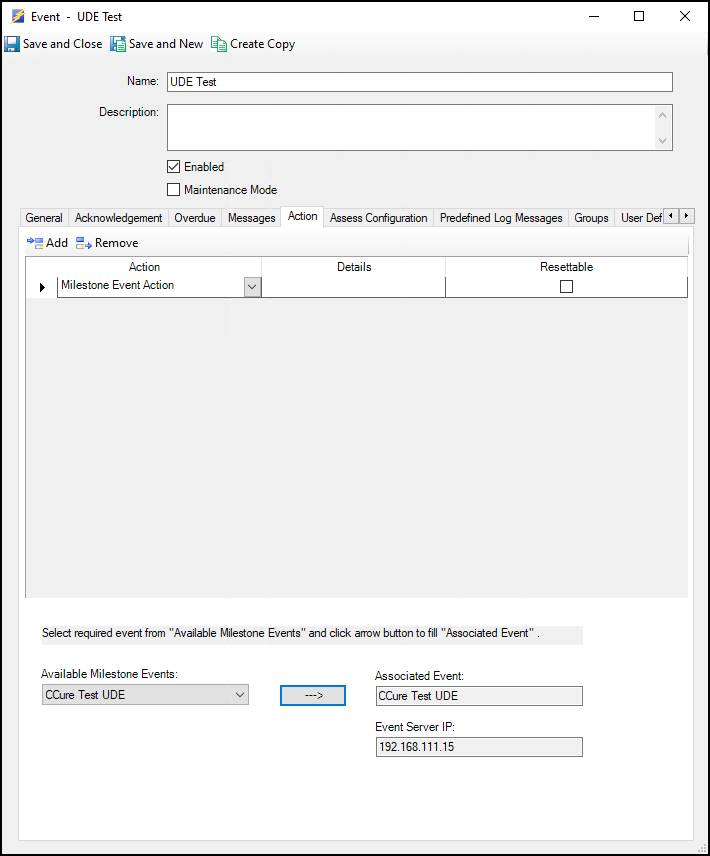

In the CCure 9000 Administration Station application, select the Configuration tab, open the list and select Event.
Click the New button to open the Event configuration window.
Enter a Name and Description for the event, select the Enabled checkbox.
On the General tab, select the Armed checkbox in the General tab.
On the Action tab, click Add, then select Milestone Event Action from the list.
At the bottom of the Event configuration window, open the Available Milestone Events list and select the already existing user-defined event.
Next, click the arrow button to move the selected event to the Associated Event. The Event Server IP address will be filled out if the user-defined event is available.
Click on Save and Close.
To test the alarm setup: open the Configuration menu of the Administration Station application. Select Event from the list and search for the name of the event.
Select the event from the Event tab, right click, expand the Action menu, and select Pulse from the menu.

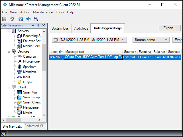

The selected user-defined event can trigger rules and alarms in Milestone XProtect. Check the Event log to verify that the event was triggered.

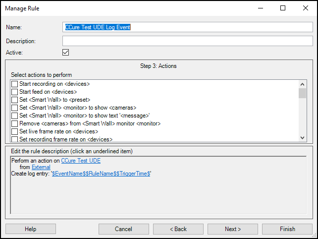

This image shows an example of a rule in XProtect that was triggered by a user-defined event:
This image shows an example of a log entry in XProtect for a triggered rule:
