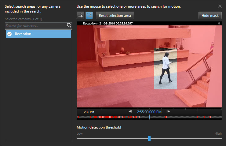

  4. To find motion in selected areas only:
    1. Below Motion, select Specify motion area.
      Search for motion in selected areas in XProtect Smart Client - part one.
      A dialog box appears with a list of the cameras that you selected in step 2.
    2. Select a camera and in the red preview area, select and drag to unmask at least one area. The system look for motion only in that area.
      Search for motion in selected areas in XProtect Smart Client - part two.
    3. Optional. Use the slider to adjust the motion sensitivity. See Motion search thresholds.
    4. Repeat step 2 and 3 for all the cameras you want to define search areas for. Motion within the selected areas are highlighted with yellow boxes.
