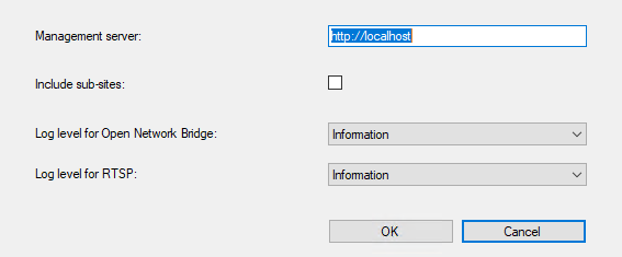

  2. Right-click the Milestone Open Network Bridge Manager tray icon again, and select Configuration.
    Replace the existing management server address from Configuration.
  3. Specify the new information, and then click OK.
