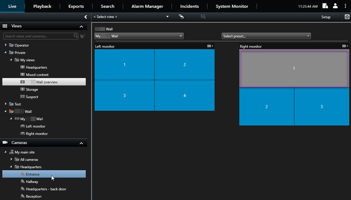

  4. To add a camera from the Cameras pane:
    1. Open a view that contains the Smart Wall control.
    2. In the Cameras pane, find the camera that you want to add.
    3. Drag the camera to a view item in the Smart Wall control.
      Drag a camera to a Smart Wall monitor.
    4. To verify that you added the correct camera, check the video wall or click the camera icon in the Smart Wall control. A preview appears.
