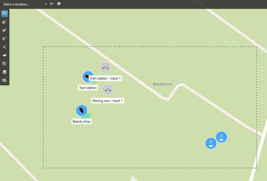

  4. To remove several cameras:
    1. On the smart map toolbar, click Select multiple cameras.
      Select multipe cameras on your smart map.
    2. Click and drag to select multiple cameras. Other types of devices, for example input devices, are not included in the selection.
    3. Right-click and select Remove cameras.
