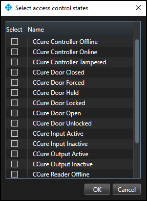

  1. Select the Access control state… option to open the Select access control states window and select from the list of all available CCure hardware states.
