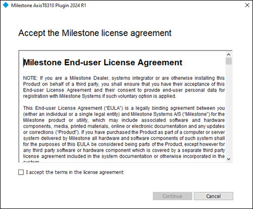

  3. Double-click the .exe file to start the installation.
  4. To install the XProtect Input Unit Plug-in, accept the terms of the license agreement and then click Install.
  5. When the installation is complete, click Finish.
