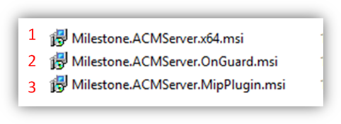

  • Always upgrade the ACM Server and the OnGuard ACM plugin on the OnGuard machine before upgrading the XProtect Event Server ACM MIP plugin.
  • On the OnGuard Server, first install the Milestone ACM Server.
  • Second, install the Milestone ACM Server: OnGuard Plugin.
  • Lastly, move to the XProtect Event Server and install the XProtect Event Server ACM MIP Plugin.
  • Here is the order of installation for all three software components of the plug-in:
