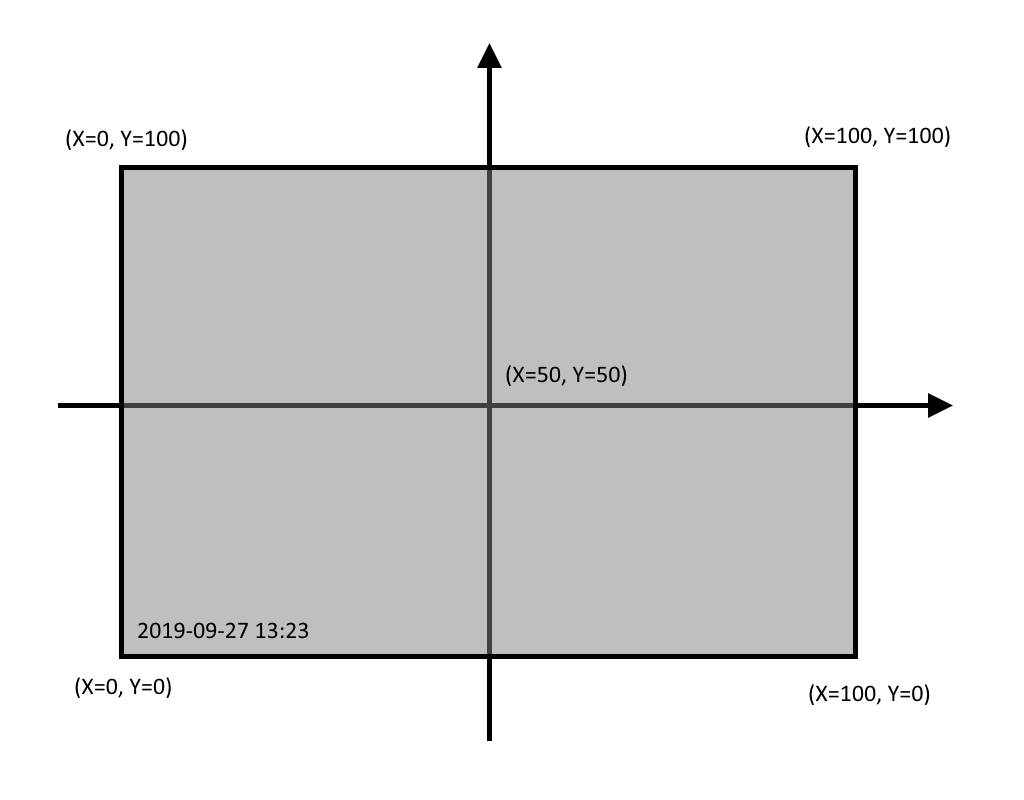

When “Custom” is available and selected for “OSD Date and Time” the “OSD Date And Time X” and “OSD Date and Time Y” control the position of the OSD on the video. The values correspond to the following positions:
Chart, diagram, box and whisker chart
Description automatically generated
