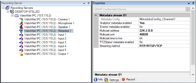

There is a Metadata channel corresponding to each video channel. Each Metadata channel can be started or stopped individually and has a single Metadata stream with configurable settings in Management Client:

Setting name
Possible values
Value taken from device
Affected features or Important notes
- Metadata Config
Name of the Metadata configuration being used.
Read-only parameter, used for information purposes.
Streaming method
  • RTP/UDP
  • RTP/RTSP/TCP
  • RTP/RTSP/HTTP/TCP
  • RTP/UDP multicast
Default value: RTP/UDP
The streaming method will always have "RTP/UDP" and "RTP/RTSP/HTTP/TCP" in the list. The other values depend on the device. If the device supports them, they will be listed. The streaming method list is the same as video streaming methods without "HTTP snapshot" value.
Multicast address
Default value: the same as the one from device.
Dynamically taken from the device. If the device does not support multicast for metadata, multicast settings for metadata will not be shown in the product.
The value will be used only when “RTP/UDP multicast” method is selected.
Multicast TTL
[0,255]
Default value: 0
Multicast port
[0,65535]
Default value: 0
'Analytics' metadata enabled
[Yes, No]
Default value: No
Enable analytics metadata streaming.
'Events' metadata enabled
[Yes, No]
Default value: No
Enable events metadata streaming.
'PTZStatus' metadata enabled
[Yes, No]
Default value: No
Enable PTZ status metadata streaming.

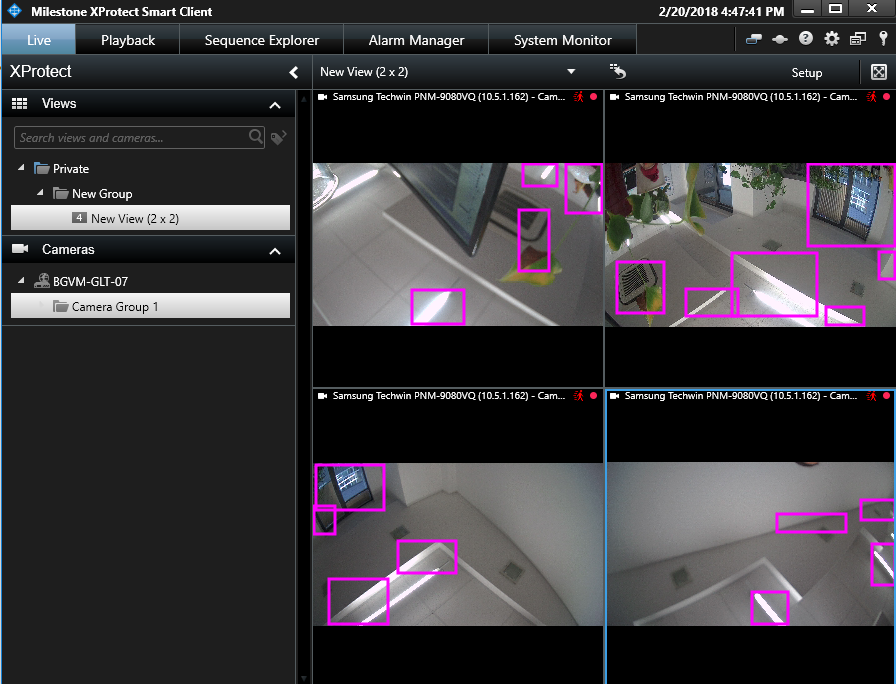

Metadata Bounding Boxes appear in Smart Client in the following way:
A screenshot of a computer
Description automatically generated with low confidence
: Currently the ONVIF driver supports handling metadata in whole finished XMLs. The ONVIF Streaming Specification states in section ‘5.1.2.1.1 RTP for Metadata stream” that there is no limitation on the size of the XML document, and it can be continuously appended with new data. The specification recommends closing the XML and starting new one at most at 1 second intervals. Due to the specifics of the internal handing in XProtect, it will not parse an XML document that is not complete and closed. This means that some analytic events might get processed too late and in the specific case of bounding boxes - not displayed at all. As the data is parsed late, the timestamp of the bounding box will be too far in the past and will be skipped as invalid. Due to this limitation, we recommend when sending the metadata to close the XML as soon as possible. In best case scenario to have the whole XML in one RTP packet.
