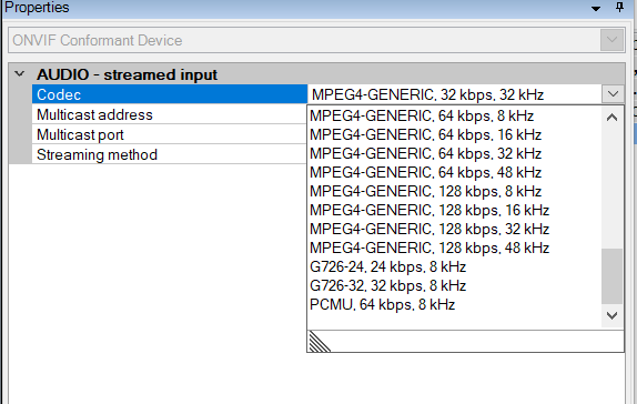

Codec
Combination of [Codec / Bitrate / Samplerate]
Default value: The first configured from the dropdown list
Supported codecs by the ONVIF driver are:
  • G711 on sample rate 8kHz
  • G711 on bitrate 64kbps
  • G726 on bitrates 16, 24, 32, 40kbps
  • AAC
Dynamically taken from the device. In the list only valid combinations of codec, bitrate and sample rate will be visible. If a specific combination is supported by the device but not by the Driver/VMS it will not be listed. When starting the Driver/Recording Server if the device is currently set to an unsupported combination, it will be changed to one for the supported list (usually the first in the list).

: The names of the codec combinations for Audio In might be different between the different devices. The ONVIF Driver is using the Audio Codec name as specified by the device. Different devices refer to the codecs with different aliases. For example, AAC / MPEG4-GENERIC / MP4A-LATM or G.711 / PCMU.
