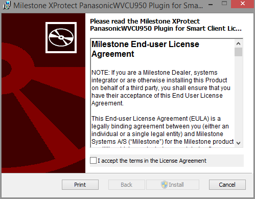

XProtect Input Unit Plug-in for Panasonic WV-CU950 Controller comes with an installer. To install the plugin, do the following:
  1. To download the installer for the XProtect Input Unit Plug-in, go to https://www.milestonesys.com/downloads/ and download the appropriate installer for your computer.
  2. Double-click Milestone_PanasonicWVCU950_Plugin_YYYY_RX_Installer_for_XProtect Smart Client.msi to start the installation.
  3. To install the XProtect Input Unit Plug-in, accept the terms of the license agreement and then click Install.
  4. When the installation is complete, click Finish.
