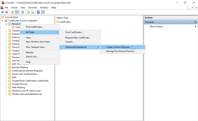

Expand the Certificates object. Right-click on the Personal folder and select All Tasks > Advanced Operations > Create Custom Request.

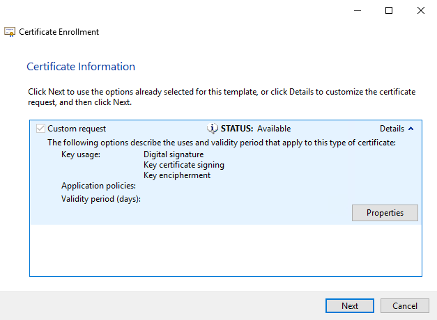

Expand to view the Details of the custom request, and click Properties.

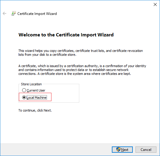

Select to install the certificate for the current user and click Next.
Choose a storage location, and browse to the Personal certificate store, and click Next.
