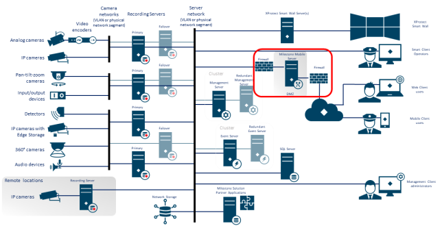

Use firewalls to limit IP access to servers and computers
Milestone recommends that you use secure connections, and the following additional steps:
- Use secure device authentication
- Use TLS
- Use device whitelisting to authenticate devices
- Use firewalls to limit network communication between servers and client computers and programs.
All XProtect components and the ports needed by them are listed in individual sections below. To ensure, for example, that the firewall blocks only unwanted traffic, you need to specify the ports that the XProtect VMS uses. You should only enable these ports. The lists also include the ports used for local processes.
They are arranged in two groups:
- Server components (services)—Offer their service on particular ports which is why they need to listen for client requests on these ports. Therefore, these ports need to be opened in the Windows Firewall for inbound connections.
- Client components (clients)—Initiate connections to particular ports on server components. Therefore, these ports need to be opened for outbound connections. Outbound connections are typically open by default in the Windows Firewall.
If nothing else is mentioned, ports for server components must be opened for inbound connections, and ports for client components must be opened for outbound connections.
Do keep in mind that server components can act as clients to other server components as well.
The port numbers are the default numbers, but this can be changed. Contact Milestone Support, if you need to change ports that are not configurable through the Management Client.
Server components (inbound connections)
Each of the following sections list the ports which need to be opened for a particular service. In order to figure out which ports need to be opened on a particular computer, you need to consider all services running on this computer.
Restrict remote access to the Management Server by adding firewall rules to only allow Recording Servers to connect to TCP port 9000.

Use a firewall between the VMS and the Internet
The VMS should not connect directly to the Internet. If you expose parts of the VMS to the Internet, Milestone recommends that you use an appropriately configured firewall between the VMS and the Internet.
If possible, expose only the XProtect Mobile server component to the Internet, and locate it in a demilitarize zone (DMZ) with firewalls on both sides. This is illustrated in the following figure.
