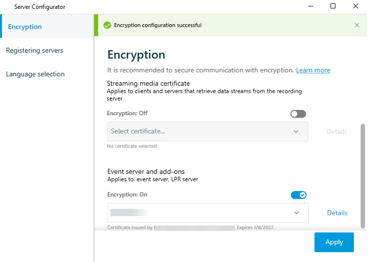

On a computer with an event server installed, open the Server Configurator from:
- The Windows Start menu
or
- The Event Server by right-clicking the Event Server icon on the computer task bar
In the Server Configurator, under Event server and add-ons, turn on Encryption.
Click Select certificate to open a list with unique subject names of certificates that have a private key and that are installed on the local computer in the Windows Certificate Store.
- Select a certificate to encrypt communication between the event server and related add-ons.
- Click Apply.
Select Details to view Windows Certificate Store information about the selected certificate.
