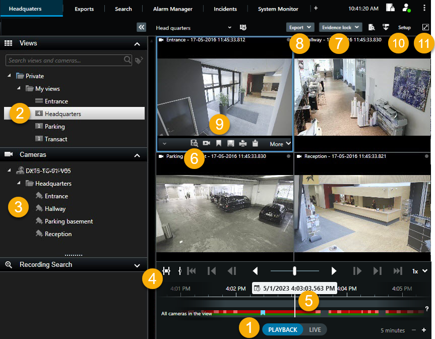

Playback mode (overview)
| Number | Description |
1 |
View recorded video in playback mode. |
2 |
Select a view in the tree structure or use keyboard shortcuts. See also Keyboard shortcuts (overview). |
3 |
Change individual cameras temporarily. See also Change individual cameras temporarily. |
4 |
Select a time span for exporting video. |
5 |
Browse using the main timeline. |
6 |
Open a new search window with the camera preselected. See also Start search from cameras or views. |
| 7 |
Create an evidence lock. |
| 8 |
Export video data. See also Exporting video, audio, and still images. |
| 9 |
Perform various actions on the camera toolbar. See also Camera toolbar (overview). |
| 10 |
Enter or exit setup mode to add cameras and other types of content to your views. |
| 11 | Switch to full screen mode. |
