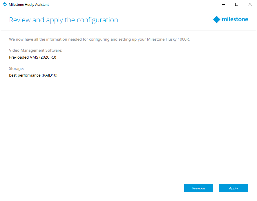

  8. The Review and apply the configuration window appears. Verify your selections and click Apply to start the process.
    The system automatically starts the Milestone XProtect installation. For more information, see the administrator manual for XProtect VMS.
