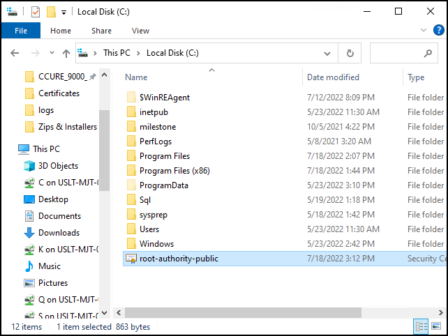

  1. On a server with restricted access, open PowerShell and run the script in Appendix A, to create a CA certificate.
  1. By default the script places the new root certificate in the C:\ file location. Move the certificate to the server that hosts the CCure XProtect Access Service.

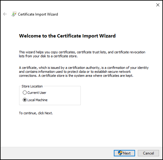

  1. Go to the server that hosts the CCure XProtect Access Service and right-click the certificate and select Install Certificate to begin the certificate installation wizard.
  1. Choose to place the certificate in the Store Location of the Local Machine.

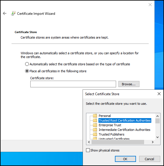

  1. Browse and import the certificate in to the Trusted Root Certification Authorities folder.

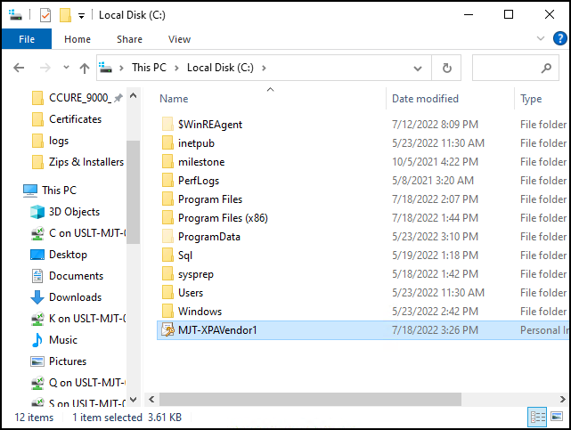

  1. Go back to the server with restricted access where you generated the root certificate, open PowerShell and enter the script in Appendix B, to generate a new client certificate to install on the server hosting the victor web service.
  1. You will need to enter the PC name of the server hosting the victor web service, the IP address of the server, and a certificate password of your own choosing during the process of completing the script. Enter this information and complete the script.
  1. By default the script generates the certificate at the C:\ file location. Copy the file and move it to the server hosting the victor web service.

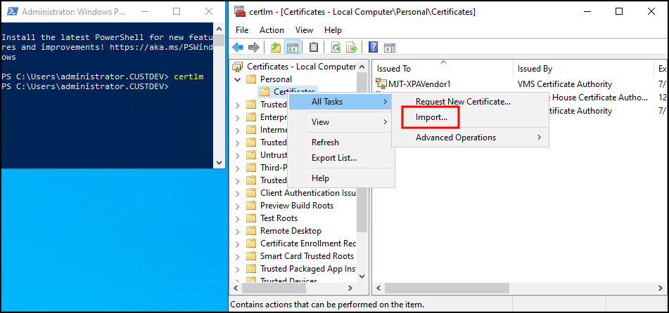

  1. Go to the server hosting the victor web service and run the certificates snap-in for the local machine. Right-click the Certificate store within the Personal folder and choose to Import a new certificate.
  1. Import the certificate into the store of the local machine. Choose the certificate file that you copied to the local server. Enter the password chosen during the script. Browse to the personal folder of the certificate store to choose that as the location for the certificate. Complete the import wizard.

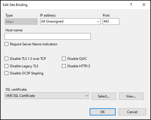

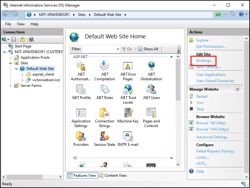

  1. The final step in this process involves binding the certificate to the IIS server supporting the victor web service. In the IIS Manager application on the victor web service host server, open the Bindings... menu of the Default Web Site.
  1. Choose to edit the https binding, select the imported certificate from the SSL certificate list, click OK and close the Site Bindings menu.
