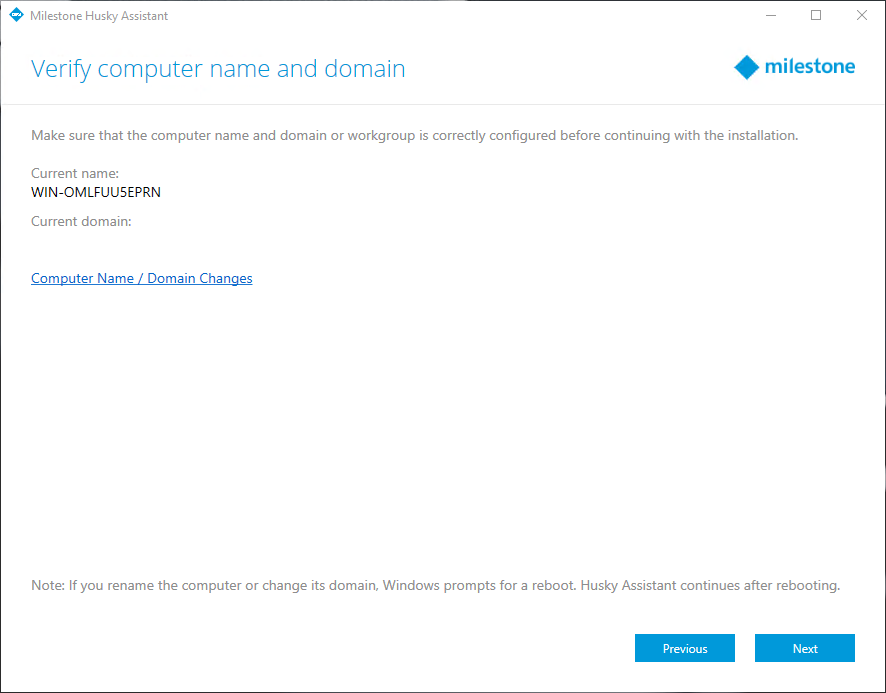

  2. Click Computer name / Domain changes to configure computer name and domain or workgroup settings.
    When completed, Windows will require a restart to apply the changes.
  3. Restart Windows and wait for Windows to boot.
    Husky Assistant restarts. Click Next.
  4. Because you have already configured the name and domain setting, click Next.

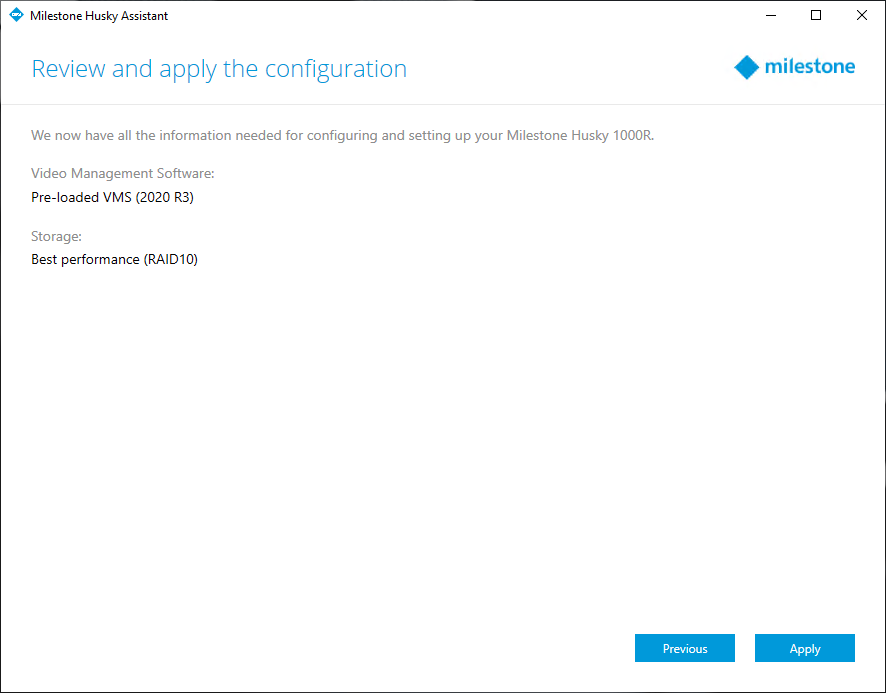

  8. The Review and apply the configuration window appears. Verify your selections and click Apply to start the process.
    The system automatically starts the Milestone XProtect installation. 有关详细信息,请参阅 XProtect 视频管理软件的管理员手册。如需详细信息,请参阅 XProtect 视频管理软件的管理员手册。
