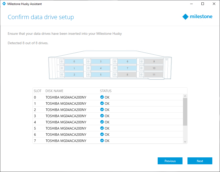

  5. Make sure that all the hard drives are detected and click Next.

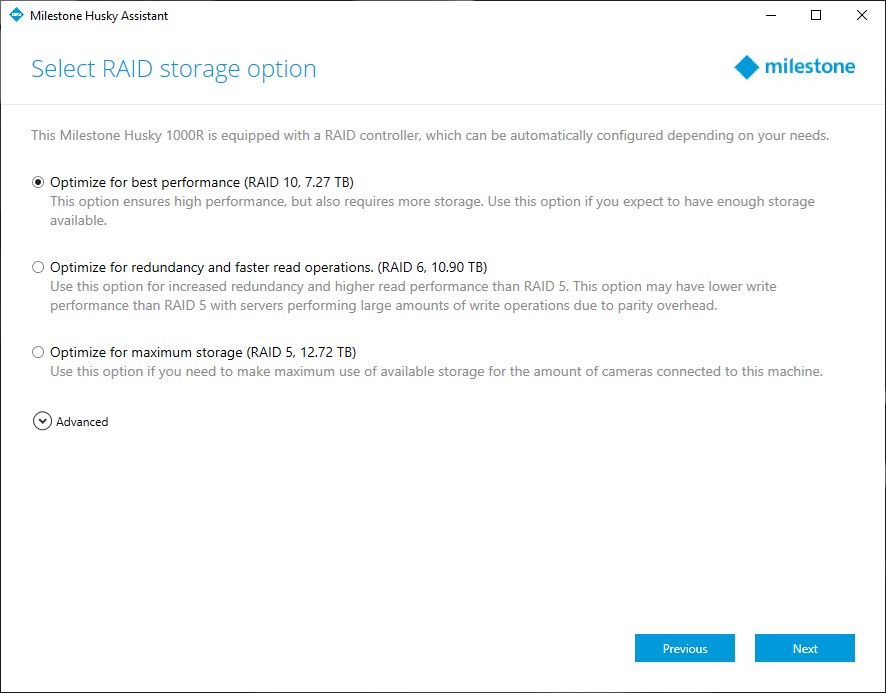

  6. Select the preferred RAID configuration to match your storage requirement. Click Next.
    The Advanced option is to manually configure the RAID using the RAID storage manager application.
