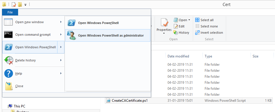

- In File Explorer, go to C:\Certificates and select the CreateCACertificate.ps1 file.

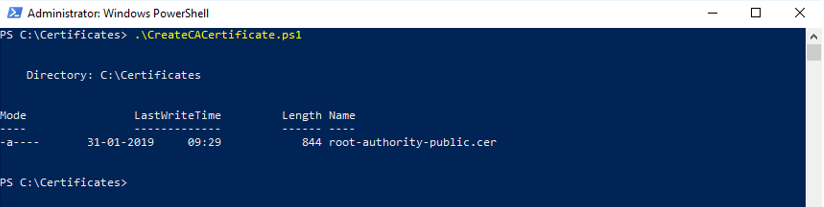

- In the File menu, select Open Windows PowerShell and then Open Windows PowerShell as administrator.
- In PowerShell at the prompt, enter .\CreateCACertificate.ps1 and press Enter.
- Check that the root-authority-public.cer file appears in the folder where you ran the script.

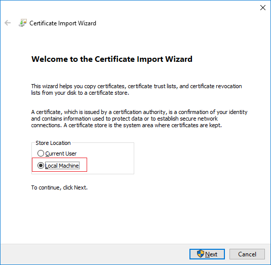

- Right-click on the certificate and select Install Certificate.
- In the Certificate Import Wizard, select to install the certificate in the store of the Local Machine and click Next.

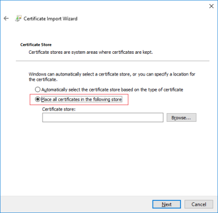

- Select to manually locate the store in which the certificate will be installed.
- Click Browse, select Trusted Root Certification Authorities and click OK. Then click Next.

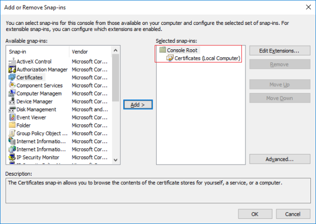

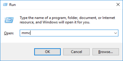

- To verify that the certificate is imported, start the Microsoft Management Console.

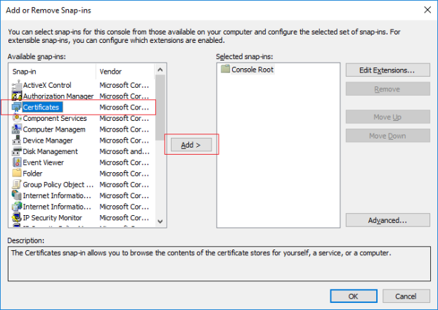

- In the Microsoft Management Console, from the File menu select Add/Remove Snap-in….
- Select the Certificates snap-in and click Add.

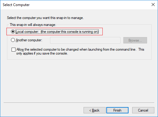

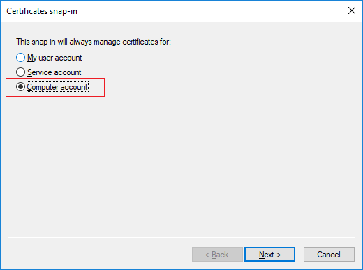

- Select that the snap-in must manage certificates for the Computer account.
- Select Local computer as the computer that you want the snap-in to manage and click Finish.
- Click OK after the snap-in has been added.

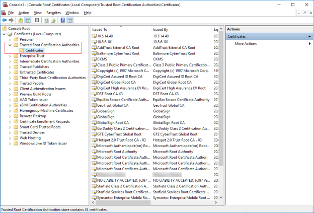

- Verify that the certificate is listed in the center view of the Trusted Root Certification Authorities subtree.

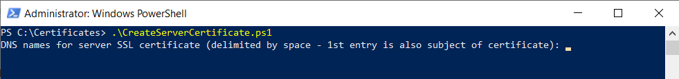

- In Notepad, click File -> Save as, name the file CreateServerCertificate.ps1 and save it locally in the same folder as the CA certificate, like this:
 C:\Certificates\CreateServerCertificate.ps1.
- In File Explorer, go to C:\Certificates and select the CreateServerCertificate.ps1 file.
- In PowerShell at the prompt, enter .\CreateServerCertificate.ps1 and press Enter.
- Enter the DNS name for the server. If the server has multiple names, for example for internal and external use, add them here, separated by a space. Press Enter.
- Enter the IP address of the server. If the server has multiple IP addresses, for example for internal and external use, add them here, separated by a space. Press Enter.
- Specify a password for the certificate and press Enter to finish the creation.
- Run the script until you have certificates for all of your servers.

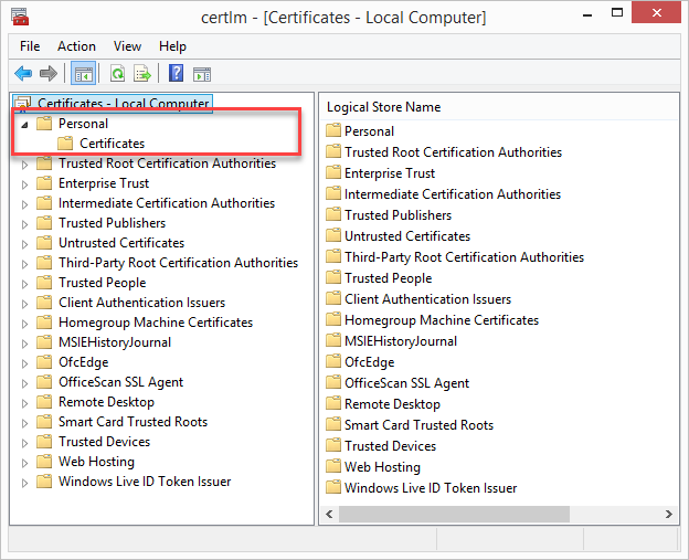

- On the server service computer, start Manage computer certificates.

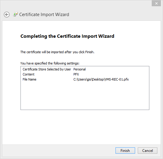

- Click on Personal, right-click Certificates and select All Tasks > Import.
- Select to import the certificate in the store of the Local Machine and click Next.
- Browse to the certificate file and click Next.

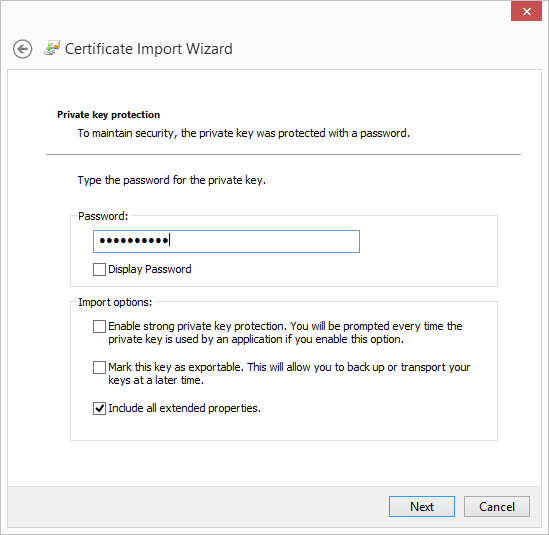

- Enter the password for the private key that you specified when you created the server certificate, and click Next.

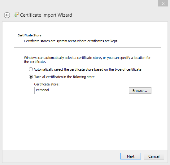

- Place the file in the Certificate Store: Personal and click Next.

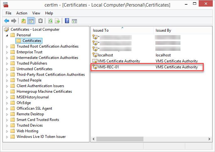

- Verify the information and click Finish to import the certificate.
- The imported certificate appears in the list.

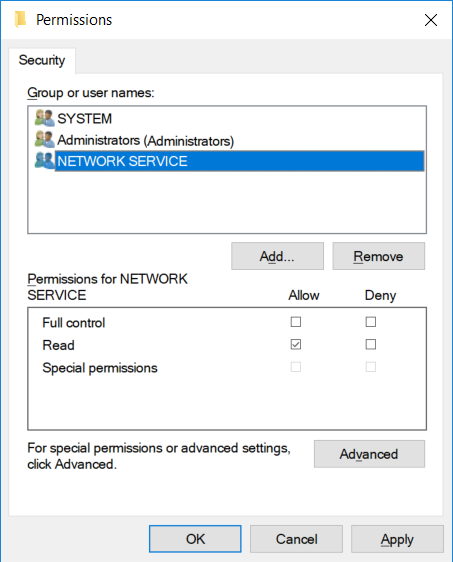

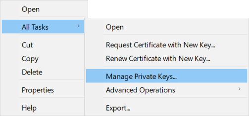

- To allow a service to use the private key of the certificate, right click the certificate and select All Tasks > Manage Private Keys.
- Add read permission for the user running the XProtect VMS services that need to use the server certificate.
