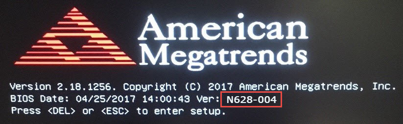

To see the current BIOS version of your unit:
  1. If your unit is powered off, turn it on.
  2. On a running unit, click Windows Start and select Restart.
  3. The first screen with a BIOS message appears. The current BIOS version is visible.
  4. Press Delete or Escape on your keyboard to enter the BIOS setup. If required, fill in the password for BIOS access.
  5. When you enter the BIOS setup utility, the current BIOS version is also visible in the Main window.
