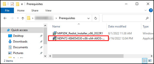

This prerequisite package is for all CCure 9000 client and server locations. You must install the .NET Framework 4.7.2 components and reboot each server or workstation prior to installation of the integration components. The runtime installation application is available in the Prerequisites folder of the installation package, available at:
