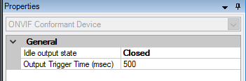

Setting name
Possible values
Value taken from device
Default value
Idle output state
Open, Closed
Open
Output Trigger Time (msec)
[100,15000]
500

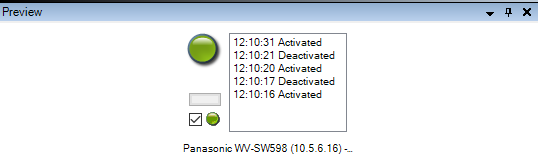

The checkbox and button in the Preview section of the Output can be used to test both modes of operation. The button starts Trigger mode, and the checkbox activates the output on check and deactivates the output on un-check. The green dot shows the current state of the output.
