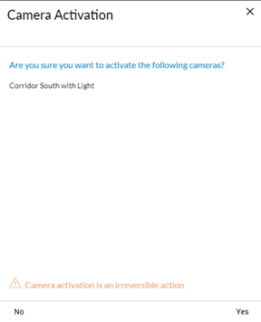

  3. Define and activate the cameras

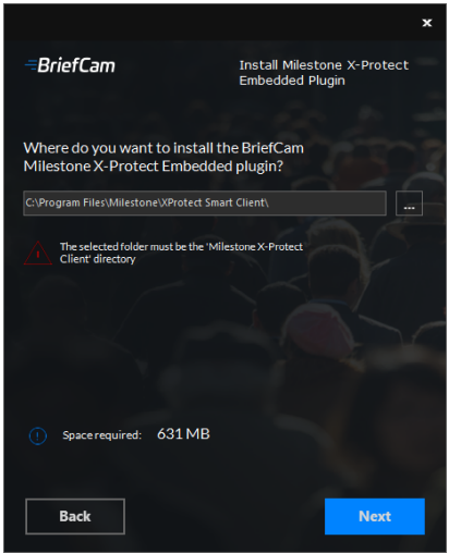

  4. Disable face recognition and license plate recognition (optional)

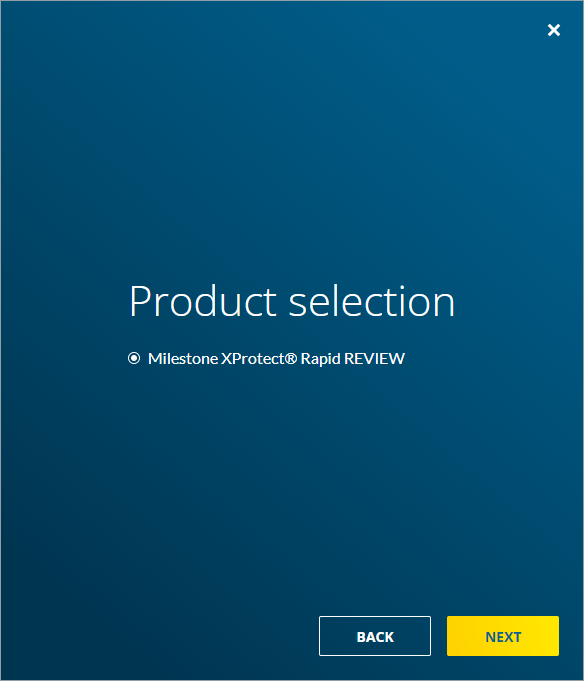

  1. Extract the XProtect Rapid REVIEW package (RapidREVIEW <version>.zip).
  2. The extracted folder includes the XProtect Rapid REVIEW installer, multiple BriefCam installer files and an installation and configuration guide. You do not need to run any of the BriefCam installers (except for the embedded client installer at a later stage).
    BriefCam uses port 80 for its application. If you want to use a different port, change it in the config.json file before running the installer. The config.json file is one of the files in the installation package.

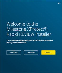

  3. Right-click the MilestoneXProtectRapidReview2022R2Installer.exe file and select Run as administrator.

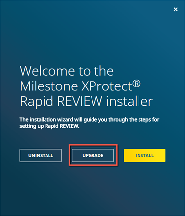

  6. Select whether you want to install, upgrade, or uninstall XProtect Rapid REVIEW.
  7. If you select INSTALL or UPGRADE, the following screen appears.
  8. Click NEXT.

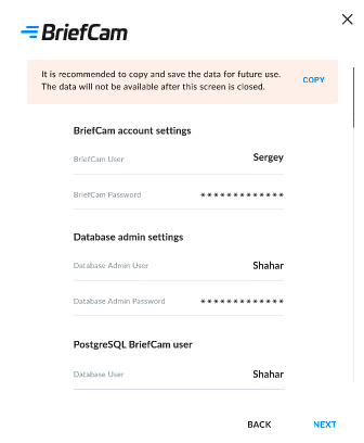

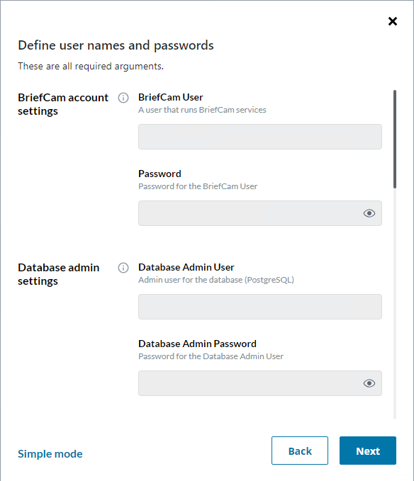

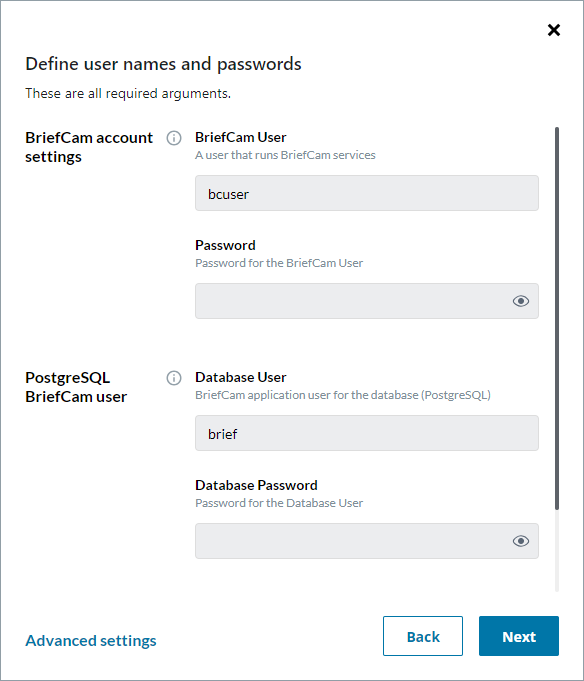

  9. The following screen opens where you’ll enter the necessary credentials and settings.
  10. Fill in the following fields.
  11. Field Description
    BriefCam account settings
    BriefCam User

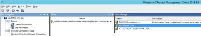

    The Windows user that runs the services. If this user does not yet exist, the installer will create it for you.
    This user must have local administrator permissions.
    Password
    The password of the user above (BriefCam User). Note that apostrophes and double quotes are not supported in the Password field.
    Use a password that is compliant with your organization’s password policy.
    A password may fail for a variety of reasons:
    • The password does not meet the password policy of the operating system and/or organization.
    • Domain accounts cannot be created using this dialog. Contact the relevant IT person if a new domain account is required.
    • The user is disabled, locked, or otherwise limited.
    PostgreSQL BriefCam User
    Database User
    The PostgreSQL user that accesses the application database.
    Note that the user name is case sensitive.
    Database Password The password of the user above (Database User). Note that apostrophes and double quotes are not supported in the Database Password field.

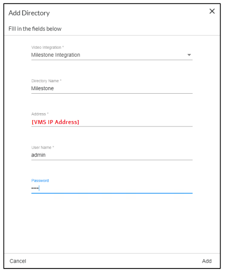

    MilestoneSSO Provider Leave as-is. This is the endpoint of the Rapid REVIEW - Milestone integration service.
    MilestoneVMS Address Enter the host or IP address of the Milestone VMS.
  14. Click NEXT and a summary screen will appear.
  15. Review the settings and save the settings for future use by clicking the COPY button.

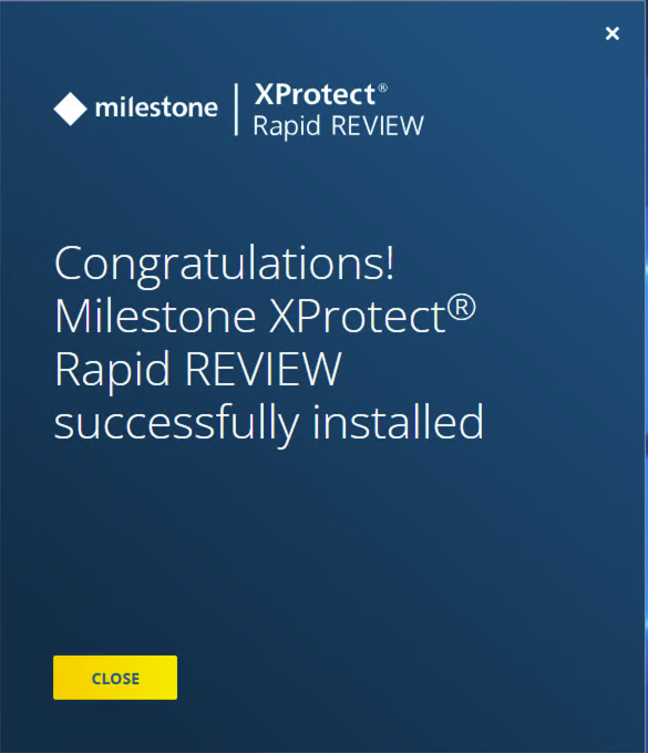

  16. Click NEXT to complete the installation.
  17. The installation may take 10-25 minutes. Note that after the installation is complete, the services will be automatically restarted.

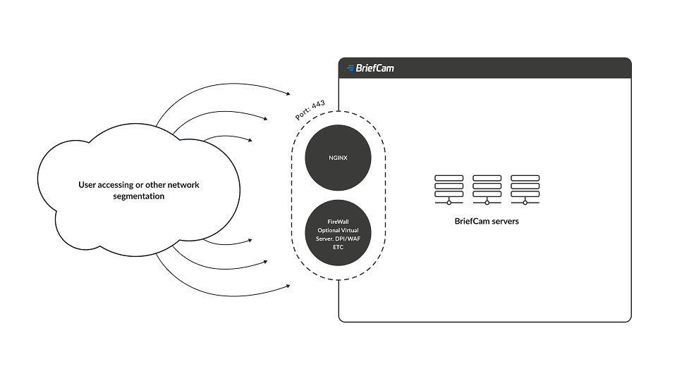

External Ports
The following ports should be opened to traffic coming from the end users’ browsers.
Component Port # Comment
Web Services HTTP (80)
Video Streaming Gateway Service TCP 5010 Not needed when using a load balancer
Notification Service TCP 7080

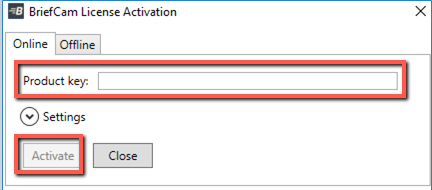

  1. From the desktop, do one of the following
    • Click the BriefCam License Activation application.
    • From the Start menu, type BriefCam License Activation and launch the application.
  2. Enter your product key and click Activate.

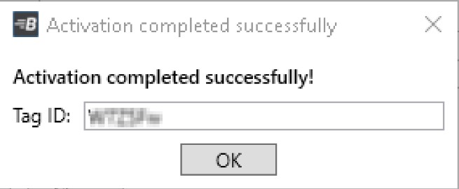

  3. When the activation is successful, the following dialog box will appear. Here you’ll find your Tag ID, which you’ll need when you open a support ticket.
  4. Click OK to close the dialog box and then click Close in the main application window to close the License Activation application.

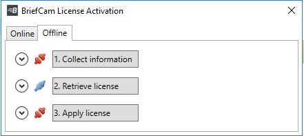

Offline activation
Offline activation is useful in cases where internet connectivity is not available on the computer where you are installing BriefCam.
To perform offline activation:
  1. From the desktop, do one of the following:
    • Click the Offline tab to access offline activation.

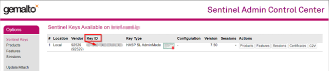

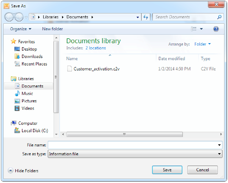

  2. Click 1. Collect Information to generate a C2V (client to vendor) file, select or approve the destination in which it is to be stored, and click Save.
  3. Send the C2V file to the Support team by logging into Milestone Support to open a ticket and attaching the C2V file. The product key number you received from Milestone needs to be mentioned in the ticket. This will help the support team generate the relevant V2C file (vendor to client), which is required to activate the product offline.

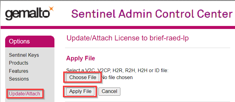

After receiving the V2C, there are two ways to activate the product offline:
You can activate via the BriefCam License Activation application or you can use the Gemalto application.
Activate via the BriefCam License Activation application
  1. Open the BriefCam License Activation application.
  2. Click the Offline tab.
  3. Click 3. Apply license.
  4. Select the V2C file provided by the support team, and click Open.
  5. When you see a message that the product was activated successfully, click OK and close the License Activation application. BriefCam will now be activated.
Activate via the Gemalto application.
  1. Open a web browser.
  2. Open http://localhost:1947/_int_/checkin.html.
  3. Select the Update/Attach option.
  4. Click Choose File.
  5. Select the V2C file provided by the support team.
  6. Click Apply File.

To make any modifications to the license, such as adding cameras to the license, you need to:
  1. Activate the license.
  2. Place an order and mention the system Tag ID and the Key ID, which can be found in the Gemalto application:
    1. Open your browser.
    2. Go to the Sentinel Admin Control Center
    3. Copy the Key ID.
    The Milestone team will then generate the relevant V2C with the requested modification(s).

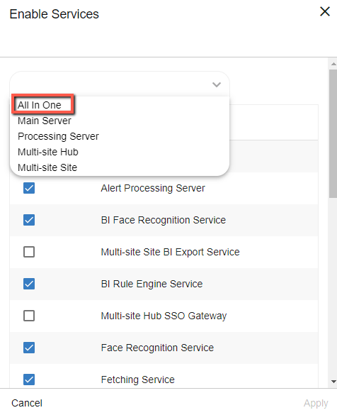

  1. From the Deployment section, click Hosts.
  2. Next to the host name, click on the settings icon .
  3. From the Templates menu, select All In One.
  1. Clear the Alert Processing Server, BI Face Recognition Service, and BI Rule Engine Service check boxes (these options will not be needed).
  2. Click Apply.

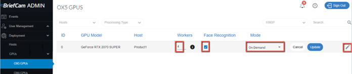

  3. From the Deployment section, click GPUs and then select GPU OX5.
  4. Click on the edit icon ().
  5. If face recognition will be used, select the Face Recognition check box.
  6. In the Mode column, select On Demand.

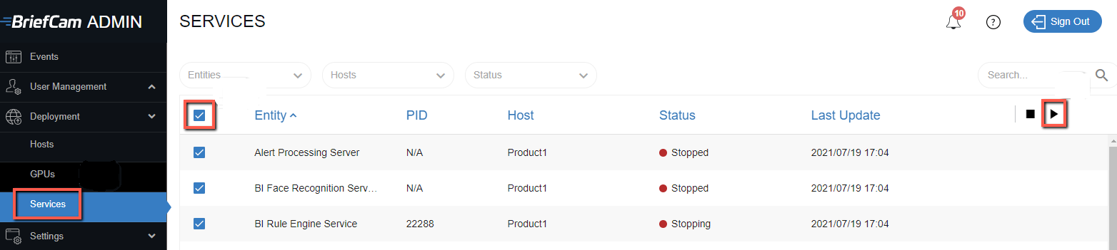

  1. Verify that the number of workers under Workers is set to 4.

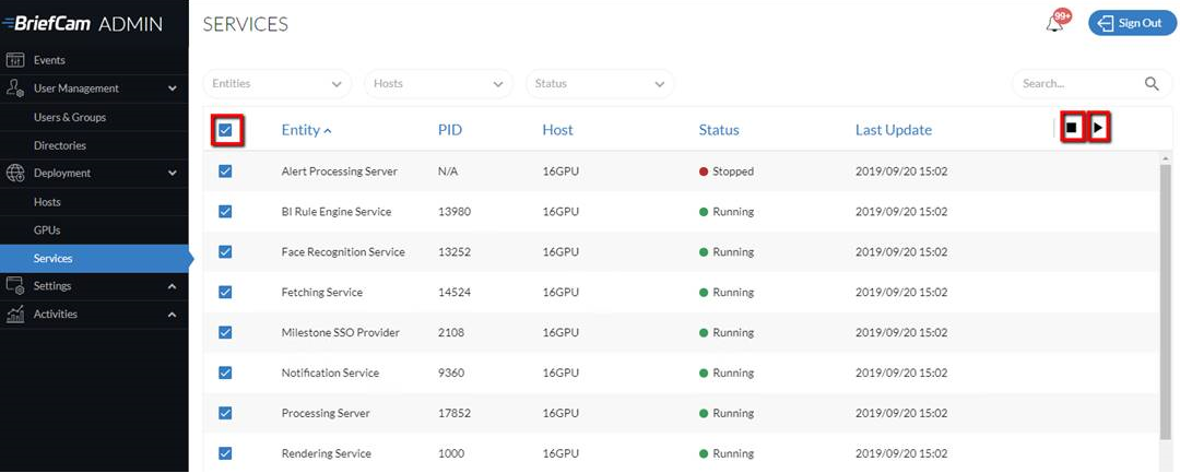

  2. From the Deployment section, click Services.
  3. Select the check box at the top left of the table.
  4. Click the start button.

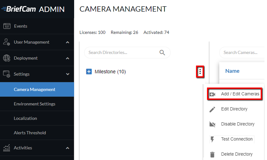

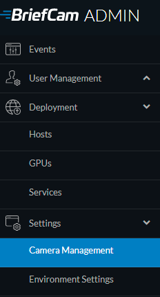

  1. Open the Settings section and click Camera Management (as shown in the image below).
  1. Click Add directory. The Add Directory dialog box opens.
  1. From the Video Integration field, select Milestone Integration.
  1. In the Directory Name field, enter a display name for the user directory.
  2. In the Address field, enter the IP address of the Milestone VMS server.
  3. In the User Name and Password fields, enter an administrator user name and password of the VMS server. With an admin user you can make sure that all the cameras can be accessed.
  4. Click Add to add the directory.

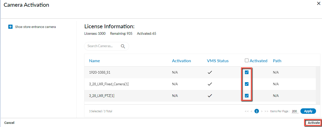

  5. Click the zoom () icon to the right of the new directory and select the Add / Edit Cameras option.
  6. For all of the cameras, select the check box in the camera’s Activated column and click the Activate button (located in the bottom right corner), as shown in the image below.
  1. The Camera Activation pane shown below will appear. If you are sure you want to activate the cameras, click Yes. Note that Camera activation is irreversible. It cannot be reset unless a special approved request is opened with BriefCam support.

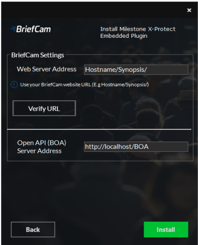

  1. Select the installation destination path and click Next.
    Note that the installation path must be the same directory where Milestone XProtect Smart Client is installed. (This may vary slightly between client computers and between Milestone versions.)
  1. Enter the BriefCam Web Application URL (which is the hostname or IP address of the BriefCam computer followed by /synopsis and verify that the provided URL is correct by clicking the Verify URL button (as shown below).
  1. In the BriefCam Open API (BOA) Server Address field, enter the hostname or IP address of the BriefCam computer followed by /BOA.
  1. Click Next.
  1. Click Install and then click Finish.

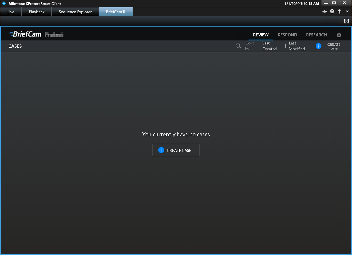

When you have completed the steps, a BriefCam tab will appear in the Milestone XProtect Smart Client.
In BriefCam, for security reasons, users are automatically logged out if no activity is detected for 20 minutes. Therefore, a user may be automatically logged off the BriefCam functionality while the Milestone VMS is still running.

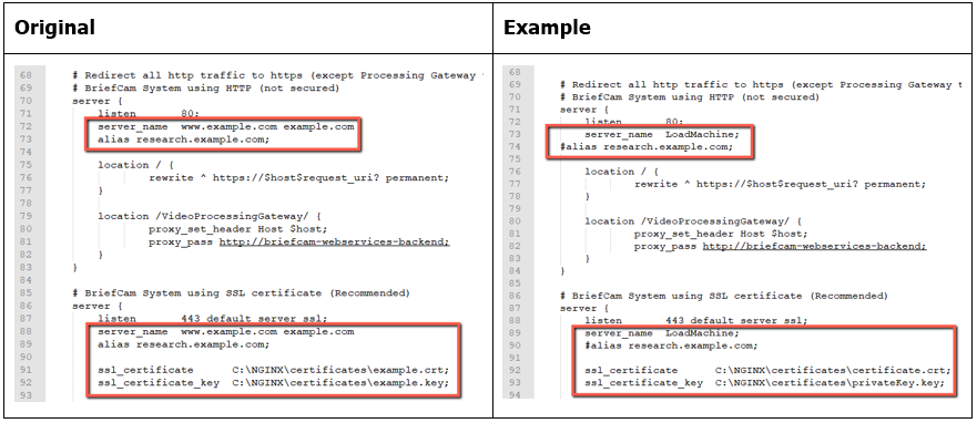

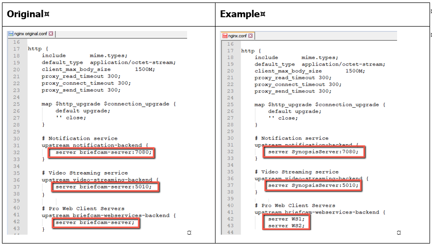

  3. In the nginx.conf file’s http section, modify the server name where the components are running (web services, notification services, and Video Streaming Gateway Services).
  4. If you have multiple nodes of a service, add a semicolon (;) after the first node and add a second row with the name of the second node. In the example below, there are two Web Services nodes.
  5. In the nginx.conf file’s BriefCam System using SSL certificate section you set up HTTPS as follows:
    1. In the server_name node, replace www.example.com with the address of the load balancer.
    2. Comment the alias node by adding an ampersand (#) at the beginning of the row.
    3. In the ssl_certificate row, enter the full path to the .crt file including the file name.
    4. In the ssl_certificate_key row, enter the full path to the .key file including the file name.
  6. If your SSL certificate is protected by a password, you need to configure NGINX to read a list of passwords that are stored in a separate file. If the private key is not in this file, NGINX will not start. You do this as follows:

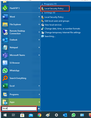

  5. Click Start (Windows key) and type secpol.msc to open the Local Security Policy utility.
  6. Go to Security settings > Local Policies > User Rights Assignment.
  7. Right-click Log on as a batch job and add the user.

Network security considerations
  • The network segment hosting the BriefCam servers / virtual computers should be separated from other networks by a firewall and access should be granted only via ports configured in NGINX. For additional information, see the Using an HTTPS Host.
  • Administrative access to the servers, such as RDP, should be allowed either over VPN or from administration bastion hosts. A bastion host is a server that allows access to a private network from a public network, such as the internet. Bastion hosts are vulnerable to potential attacks and should be kept as secure as possible.
  • If DPI / WAF/ URL protection are required – they should be implemented on the firewall when pointing to the operational BriefCam NGINX host.

To upgrade XProtect Rapid REVIEW select the UPGRADE option on the installer screen as shown below.
Note that using this installer to upgrade XProtect Rapid REVIEW, you can only upgrade from version 6.1 or above:
  1. Stop all BriefCam services and close all open applications before starting the upgrade process.
  2. Select the UPGRADE option on the installer screen.
