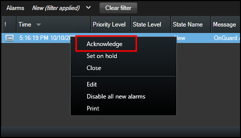

There are improvements to how alarms change state in the integration.
  • Acknowledging an alarm in XProtectchanges the alarm state to in progress both in XProtect and in OnGuard.
